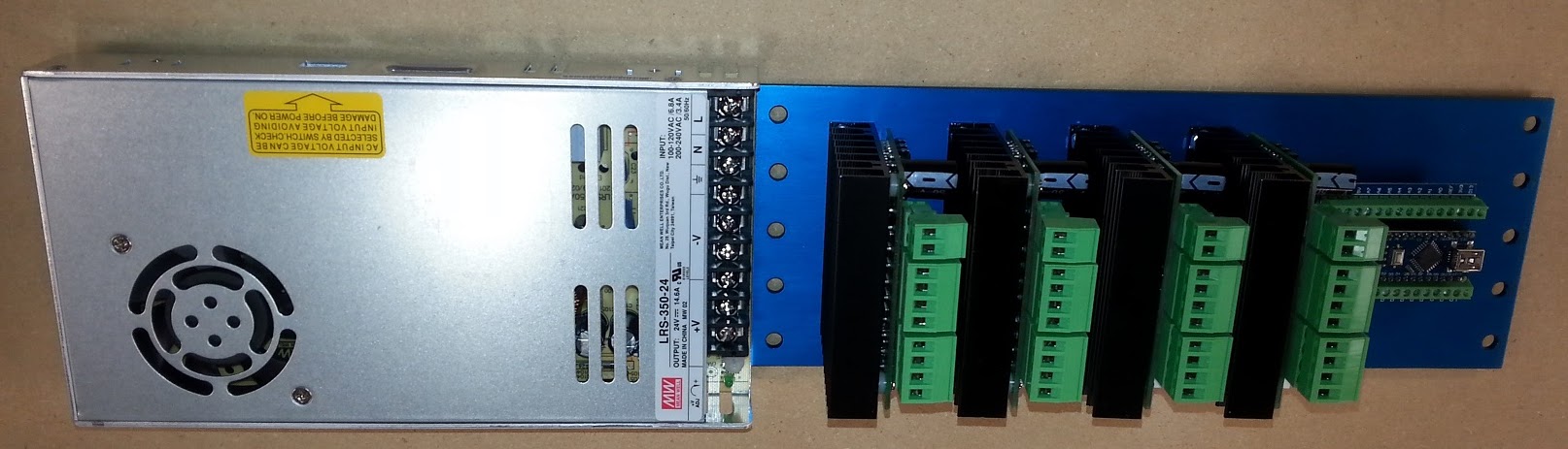

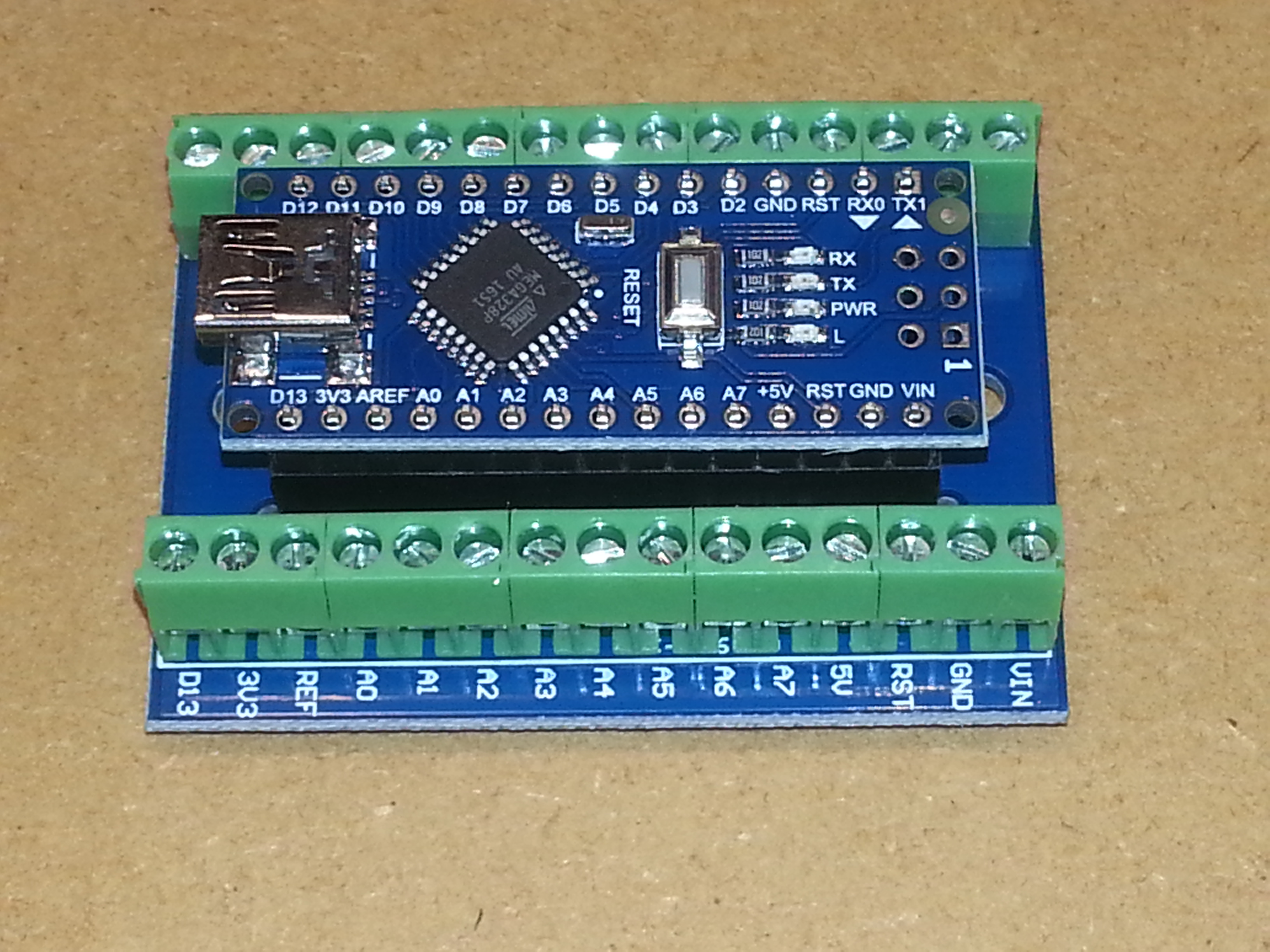

If that doesn’t work, buy a $5 Arduino Nano, a $5 screw terminal motherboard for it, and some Sainsmart TB6560 stepper drivers and wire up your own driver system. Cost you 1/4 of what the TinyG does, and you can update your own GRBL software instead of sending your board back to Synthetos to upgrade theirs. And, you’ll have a MUCH more robust, reliable, and repairable system.

So for other boards you are suggesting a Arduino? I have a few UNO’s is the nano the same just smaller? And you load GRBL software onto it? Or do you have other suggestions for boards that are decent for beginners?
@Nick_Portelli Yep, a standard Uno will work fine. I used to use an Uno with screw terminal shield, but the Nano is just easier to use and more compact. Same processor and I/O layout. I load GRBL using a small free program called Xloader. Go to my website http://3DTechWorks.ca and have a look at the Blog. Everything you need to know is in there.
