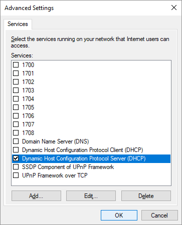

After quite some experimentation, I am able to serve DHCP on Ethernet in Windows 10. It really gets messy in 10 so it will take a while for me to update the guide. But since you are quick in technical solutions, I’ll give you some quick hints.
- Your screenshot shows that your Windows Ethernet is set up as DHCP client. You must set it up as DHCP server.
- The method to do this is to select a different interface, e.g., WiFi, to “share” Internet, as shown in my original guide.
- In Win10, that is not enough, unfortunately. You must explicitly tell the “share” which services to share. Of course, the only one Ares cares about is DHCP server. (Not sure why DHCP client is even listed as a service! But do not select that one.)
- Not only must you explicitly select DHCP server for sharing, but you must also Edit in order to specify which interface you want to share this service to.
- In order to specify Ethernet as the the destination for this service, you must not use DHCP in Ethernet configuration; instead, you must specify a static address for Ethernet. Make sure the address is on a different subnet from that on WiFi.
If the address you specify in WiFi sharing for DHCP server matches the static address of your Ethernet card, Windows will assign a new address to Ethernet, and start offering DHCP service to any device connected to it. (Unfortunately, G+ comments only allows me to attach one screenshot.) You should be able to ping octopi (or octopi.local) at that time. (You may need to restart Ares.) If not, arp -a should reveal its IP address.
