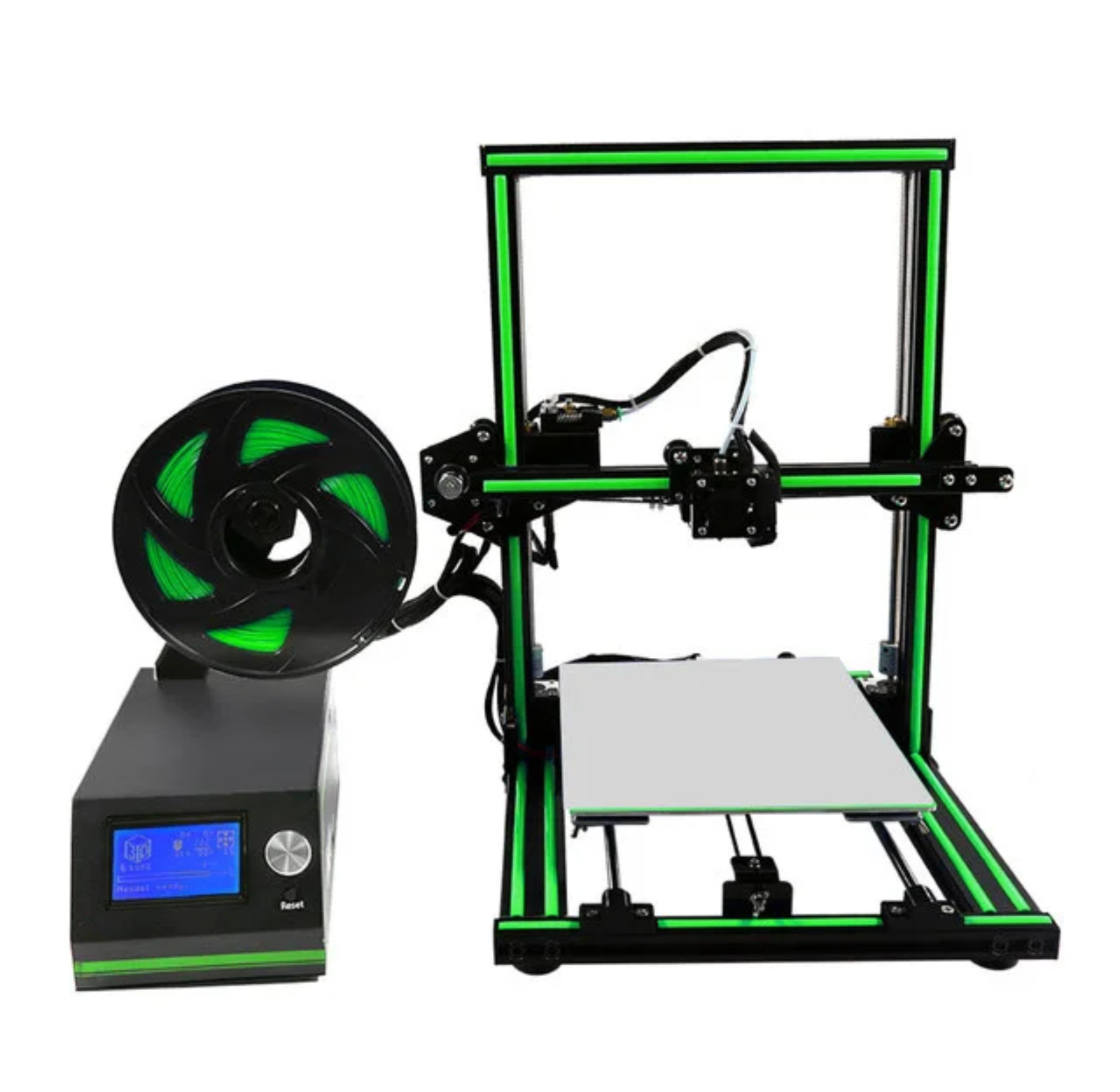

Ok so I have an Anet E10 and overall, it’s an ok printer. I’ve had to make some upgrades here and there of course but I’ve been recently having an issue and I think a motor may be going bad but I’m not sure. When the extruder motor is trying to push out filament, it will “skip” if it’s pushing too hard. Now the printer at work will eat right through the filament if it gets jammed where as my printer will “slip” and NOT chew through the filament. By slip I mean the motor will slip, not the filament. My question is, how do I tell if the motor is actually failing, can I turn up the power or are there some other things I can try? I thought about trying to swap a motor. My X axis motor doesn’t have to work that hard so I thought about switching them. Also, if I were to replace the motor, what would be a good one to get? I don’t have tons to spend but I also don’t want garbage and I don’t want to over load the controller either. Suggestions?
