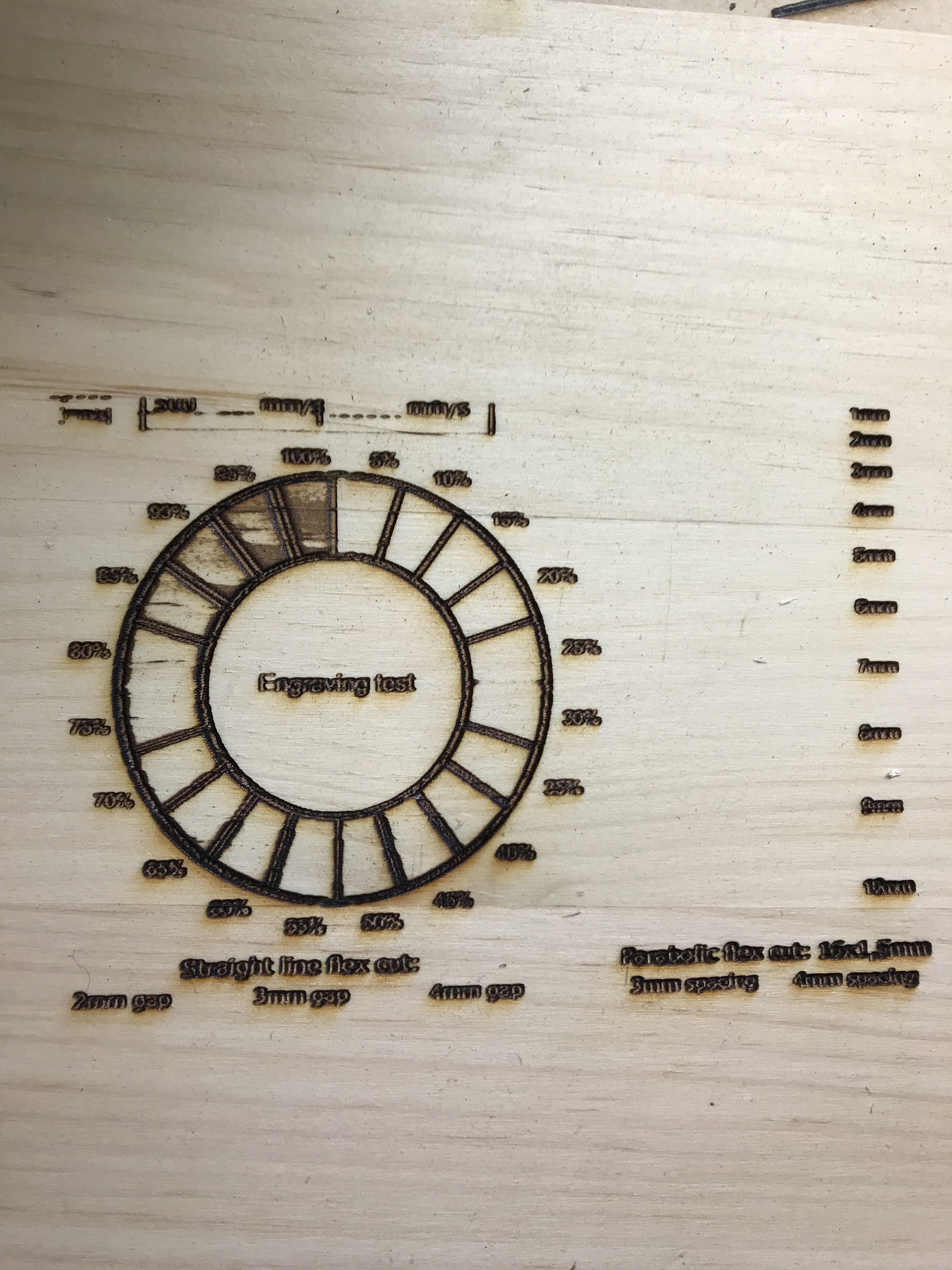

Ok so I’m trying to get some speeds and laser power down for some cutting and I can’t figure out the issue. I did this image as a PNG and Raster but as you can see it’s not shading in the blank places. Burn white is one and grayscale.

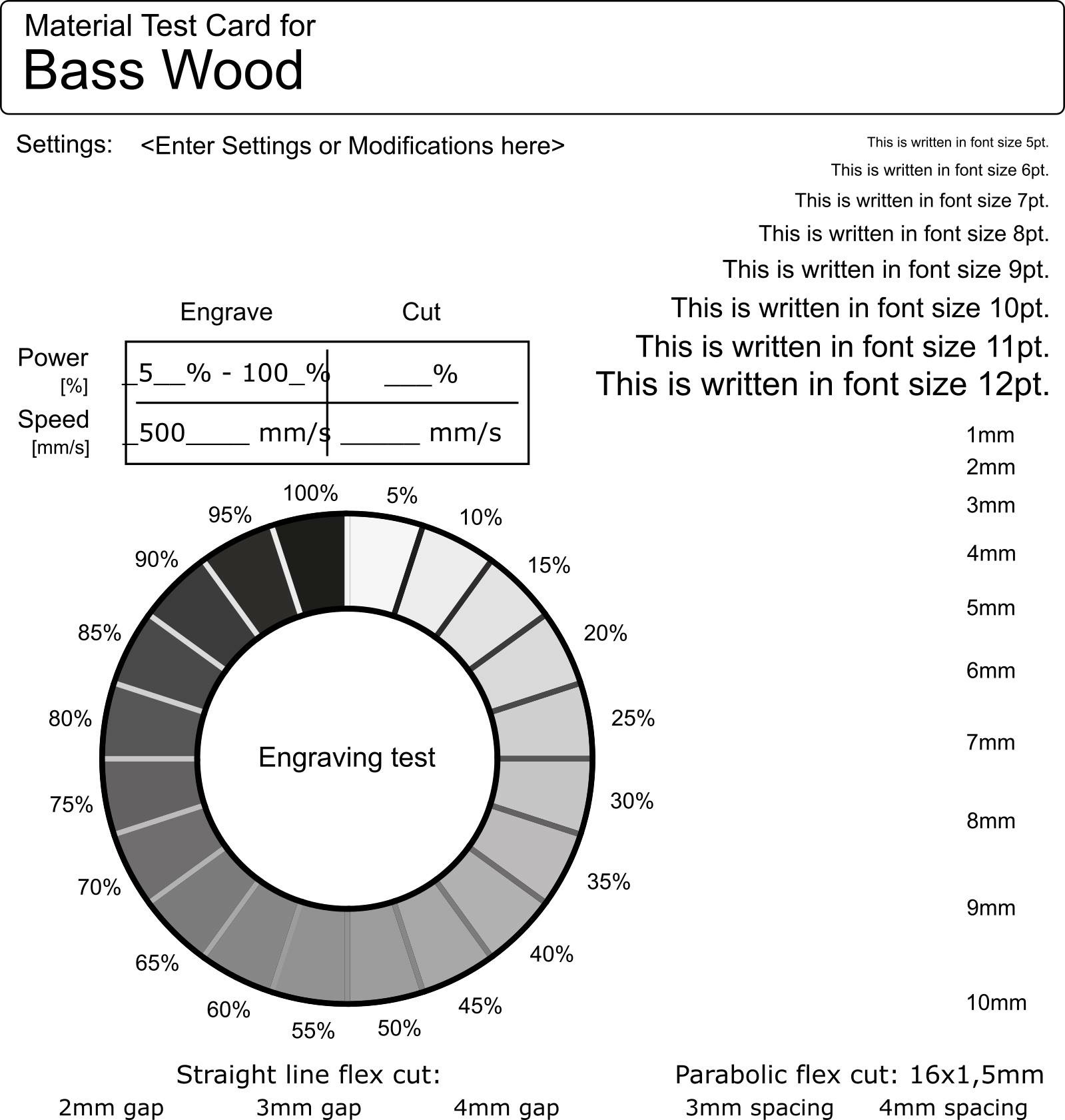

I got this image from OK so I got this file from https://www.thingiverse.com/thing:2243854 I’m using a Shapeoko 3, 1.1 GBRL, 2.8W Jtech Laser. I add the document in and tried to create Goode as a raster image.
