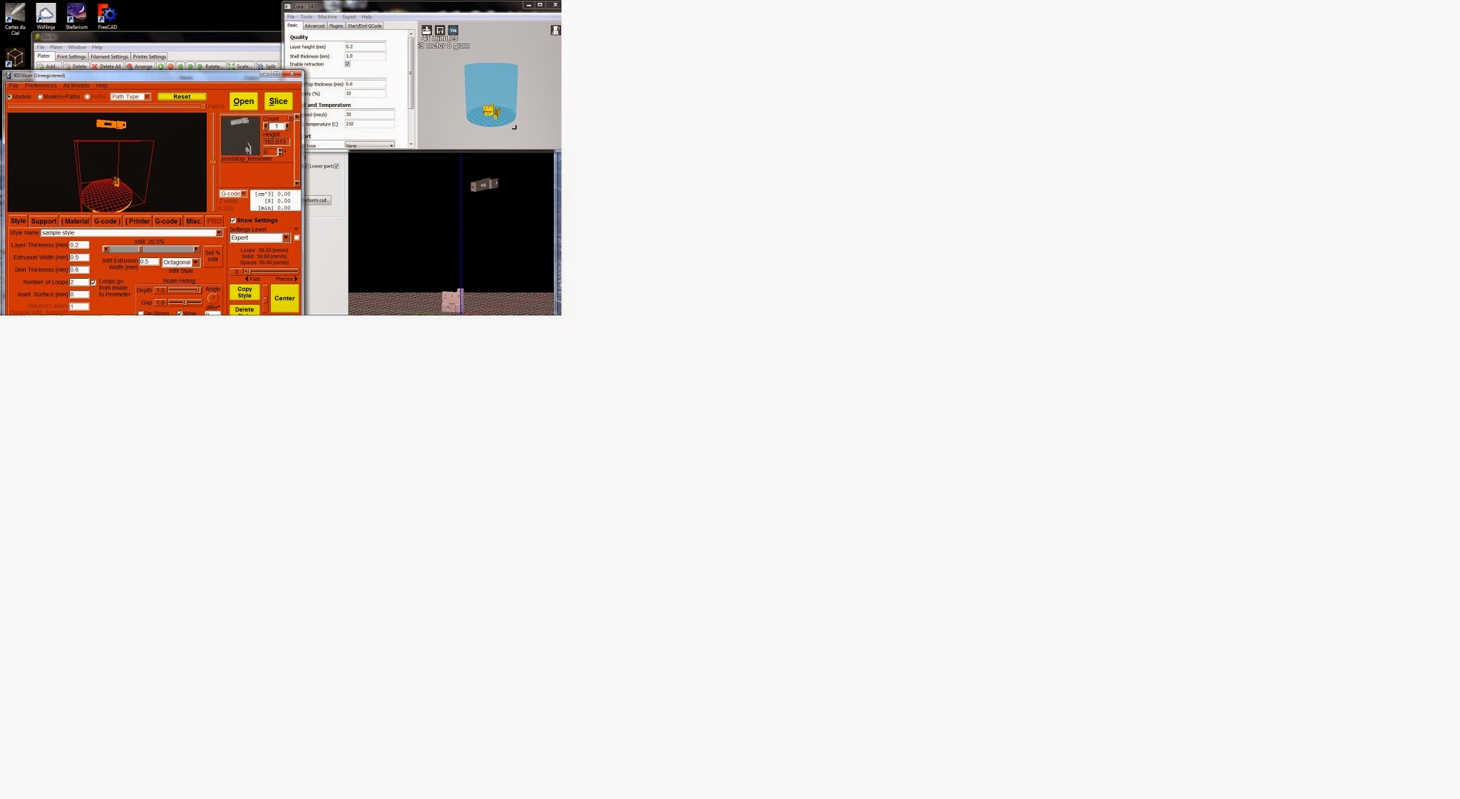

So I’m trying to make platters of 2 or more .stl 's using Slic3r and I’m having a problem w/ 2 .stl 's. Individually they are in the center and on the platform but when I load the one then the other(both are small parts) one ends up on the platform and the other is in mid-air. In Slic3r I can move the parts in X Y plane but not Z(or I haven’t found it yet). And I fixed the problem in Cura but it saves the platter in an .amf format that Slic3r and KISSlicer(my default slicer) do not recognize.
