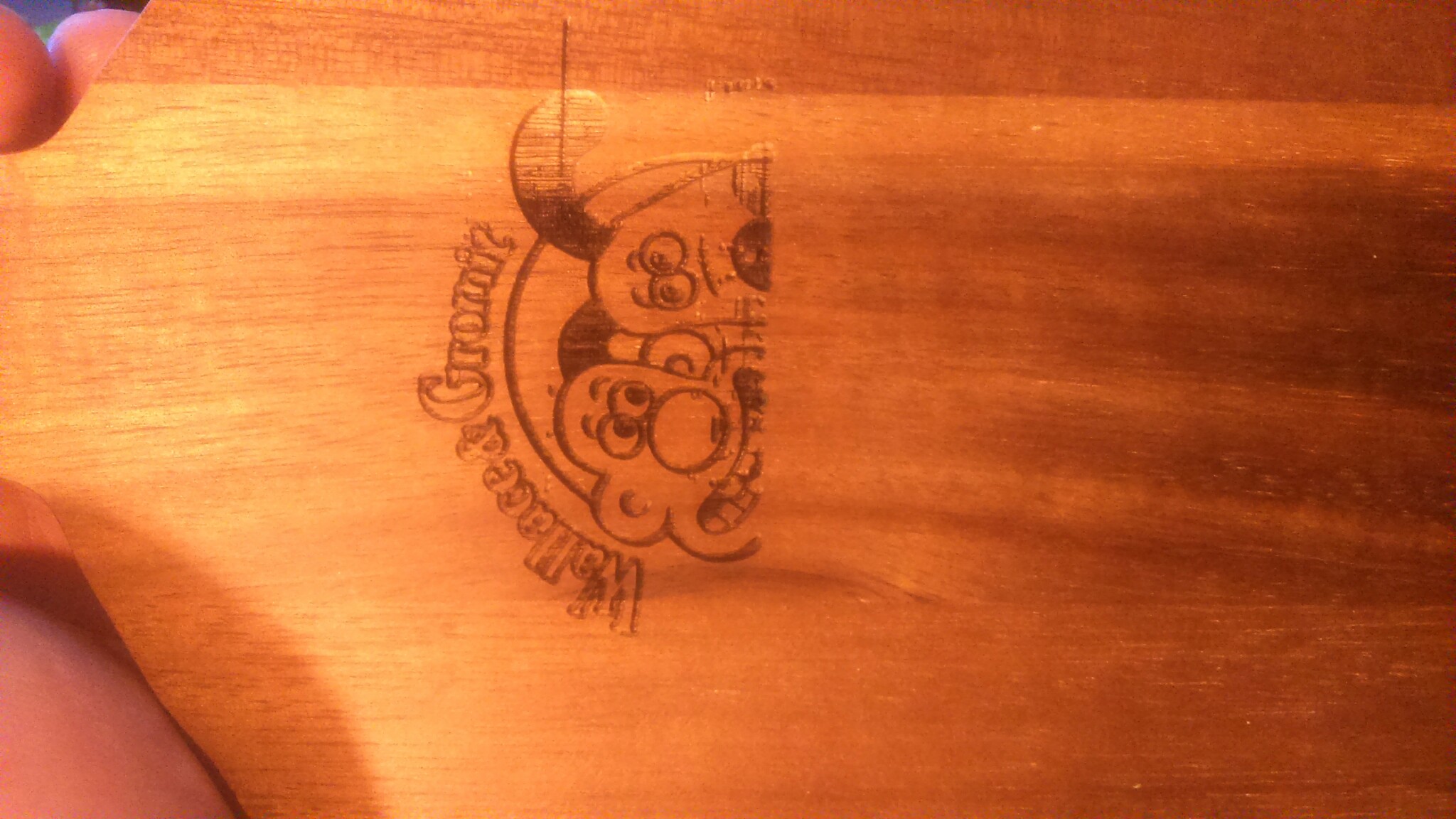

@HalfNormal ​ I’ve just got it working to a degree, it’s moving again but after trying to engrave a couple of bits it is struggling again. I managed to do the image below but as you can see it failed. Everything just stopped this time the laser the X and Y. I reset it tried again and it stopped in the same position again. I think I best just wait for my new board.
It was worth the try!
Yes it was. I took the optical stops out and cleaned them also and checked all connections so I am at a loss now. (Hurry up new year and Cohesion3D)
