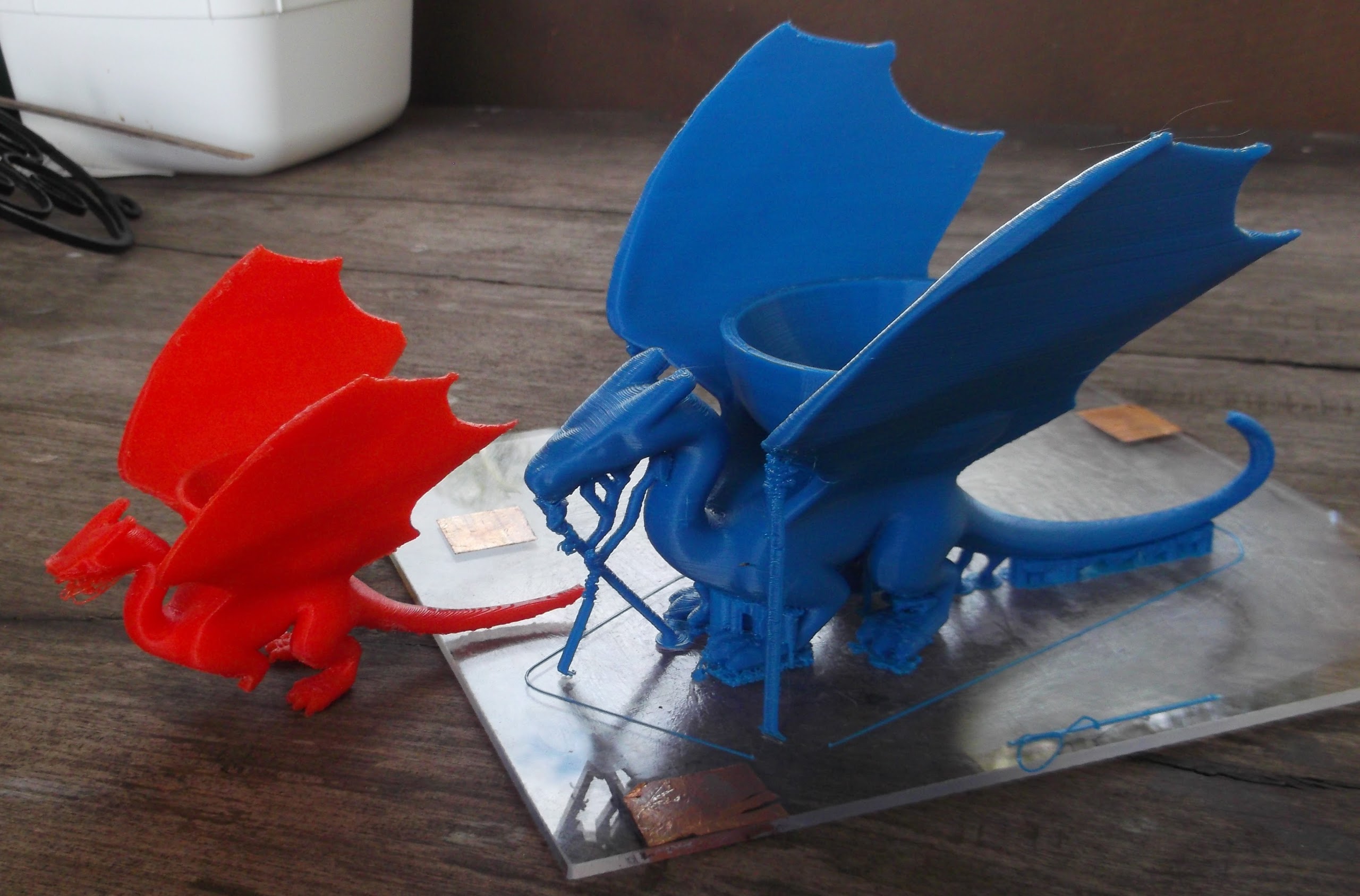

Ok… So these photos are a week old… But FINALLY got this dragon printed! After 5 attempts, this is the first /complete/ print!
The red dragon is my best previous attempt, he was left in a public place for a few weeks and got dropped, so lost his forepaws and tail tip.
So I thought I’d share one trick at removing complicated prints from glass. I print using either Uhu or Elmer’s purple glu-sticks(stinky!) on a 3mm Borosilicate(‘pyrex’) glass bed.
Either let your print cool down to room temperature, or if your using Borosilicate glass(Not safe with soda-lime glass) fresh off the printer, and strait into a freezer(Dragons must be positioned facing away from icecream, or they’ll steal it). Then it’ll either fall off the bed, or come away very easily.
Don’t leave your print on the glass overnight being cool, moisture gets absorbed back into the glu-stick and makes it tacky again. If this happens, set your printer to heat the bed for 30mins first to dry out the glue again.)

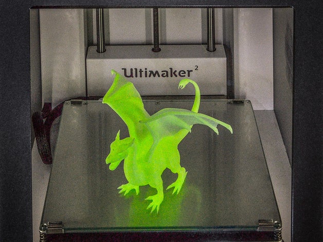

And in case anyone else wants to know what the model is: https://www.thingiverse.com/thing:275162
Those look like Meshmixer supports…?
@raykholo yep! They are both very clever and somewhat stupid at the same time.
Ended up using both meshmixer /then/ slic3r’s supports.

This the challenge I hope to one day do:
(That’s the meshmixer surport version of the original. But yeah. Best have a well tuned printer.:slight_smile:

I had 1 or 2 support pillars detach about half way up. The base of the wings is really thin (only 2 extrusion widths with no gap fill in between, and some areas even tried to do a single extrusion width)
Overall came out quite well, pillars snapped off easily.
