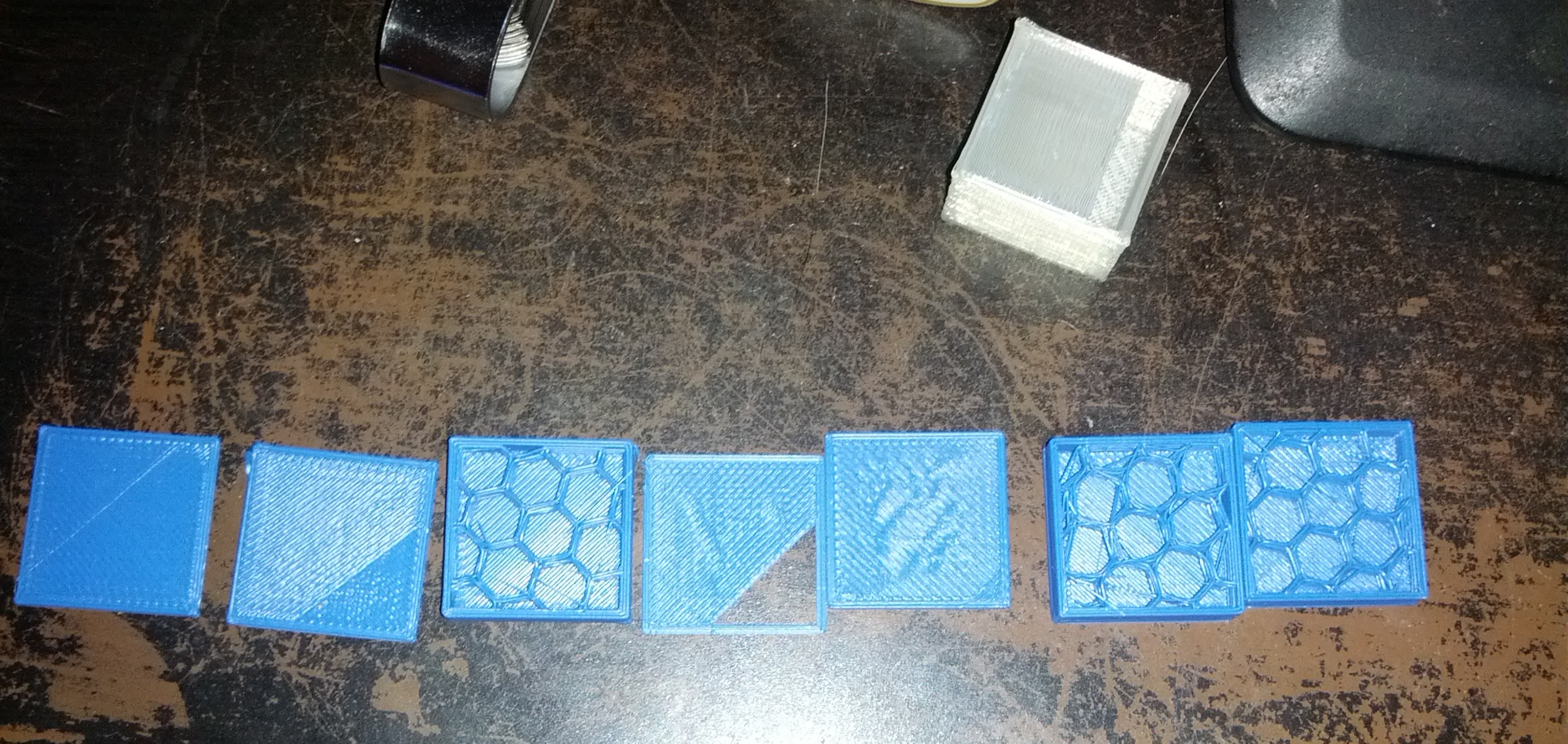

Edit: Lowering temps just made prints worse. The first picture shows me changing z height in case of compression and upping the filament diameter to forcibly thin the plastic. Same results throughout with bad adhesion by the last cube since it printed rather lifted from the platform.

Yea I agree with you that its normal for some oozing, but nothing like in the second photo where you can see the excess pulling as the extruder left the model. Just note that I’ve looked into my head being too low (usual curprit to ugly first layers) but I’m kosher there. The first photo shows my attempts to remedy the issue through diameter & multiplier. The last one is so lifted it didn’t get any good adhesion. All my corners look ugly from flowing out during lifting on the z.

@Tim_Rastall I’ll give that a try, lets see how low I can get it before it stops up. @Joseph_Chiu It’s not my Z height, we get bad adhesion and it still plows through. Filament diameter was exaggerated a by .5 and still no changes. It’s gotta be a false reading of temperatures or I’m stumped! @Dante_Ranieri I think its circular but I’ll confirm that soon.

Now, I forgot to mention, my first picture on this post is a mix of raising the z endstop and exaggerating my filament diameter/multiplier on a 20mm box. My usual go-to fixes, ze aren’t working!? lol

I’ll look into both of those @Ivan_Fernandez . @Wayne_Friedt , there is little to no thinning of plastic when exaggerating the filament diameter.
At some point, it should. Try adjusting by about 10-15%. Also, some slicers have settings to over-extrude on the first layer – so make sure that’s not the case here.
