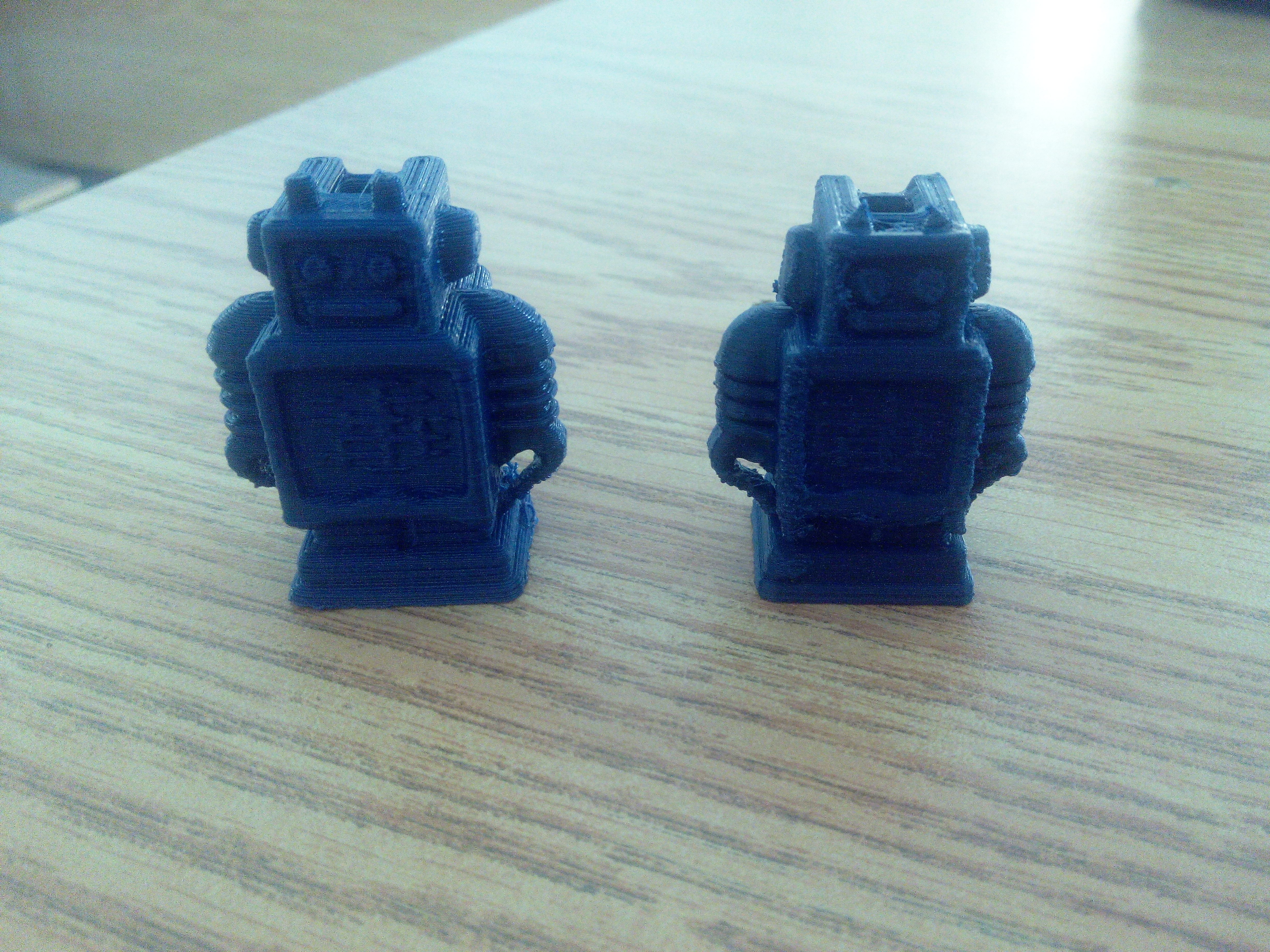

On the left is the second print 0.25 MM layer size
100% extrude
Now I will play around and fine tune.
Again thank you to all
Makes a big difference! I would definitely check the calibration on your extruder. Somehow mine had changed… a lot and my prints went from nice to crap.
Now I am going to see what I can do… Thanks again everyone
Extruder resolutuion should be set under 0,01 mm/step (microstepping?). And the retract can be better :slight_smile:

@Keith_Applegarth Sometimes if you only do software calibration when you update software it can reset parameters to default. This is another advantage of firmware calibration over simplistic GUI software calibration. Also, if you decide you want to use different software, the firmware calibration should allow software settings to be accurate at software defaults. Most software sets the extruder scalar to 1, this is much more accurate than a scalar scalar (software+firmware), nobody likes to do extra math, not even little computer robots.
It was a firmware reset from the lcd on the printer. I had reset to default. I had to reload my extruder esteps.
