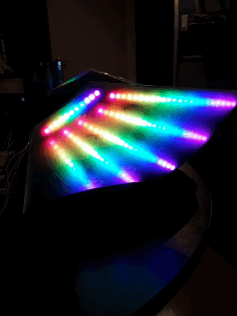

Ok, with some help, I got my multi-array sketch to work and its doing this really nice flowing rainbow pattern but I have no idea why. I really like it, I think its pretty cool but would like the flow to go in the opposite direction. Any ideas?
Here’s the sketch: http://pastebin.com/Vie6DGQc
