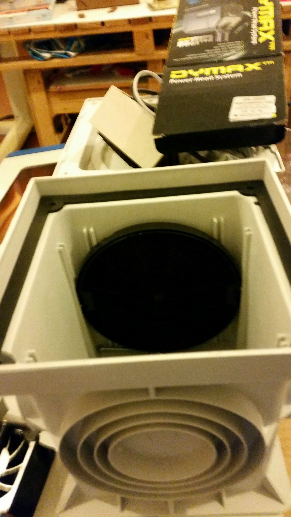

For air filter find a take from hardware mall (leroy merlin) for eletric catch basin + 15mm carbon active filter + foil kitchen filter and use server fan for additional extractor.
