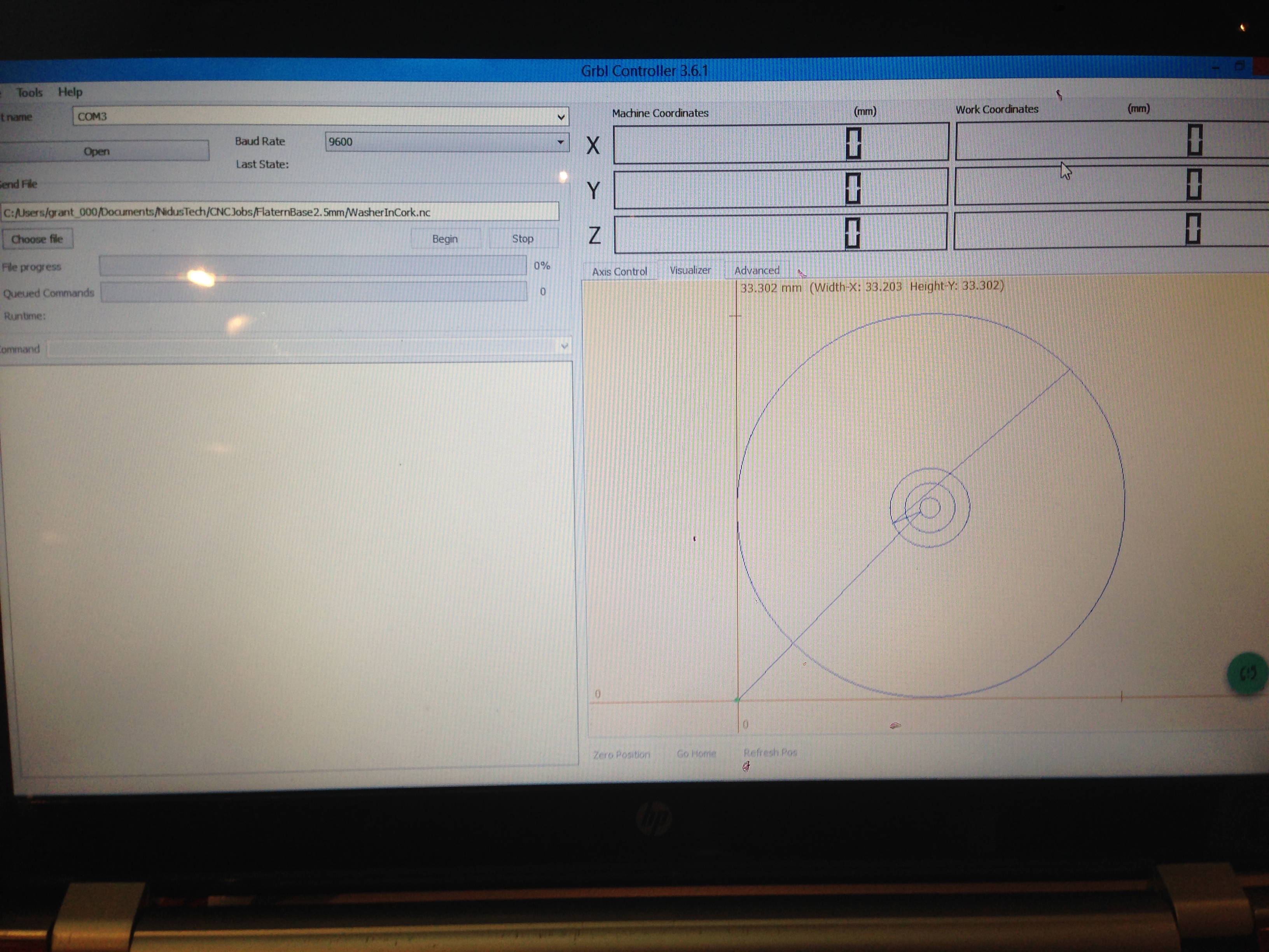

Okay have to start this again to add more pics.
It started like a circle and ended like a star! Opps
I think this is the problem, the code has greater than 4 decimal places!! A know issue I believe, but why generate it like that ?
(Generated by PartKam Version 0.05)

Most cam packages have a way to cap the number of decimal place to only 4.
So what is an easy way to limit the decimal places?
If I were you, I would check the code posted on the grbl github under Gcode examples.
The code they have is a great deal less bloated than the code you have posted.
https://github.com/grbl/grbl/wiki/G-Code-Examples
Thanks one to try in the morning
So I have confirmed the issue. Makercam exports many dp’s when using cm’s and only a few dp’s when set to inch’s. So I have downloaded CamBam and have spent all day trying that out. I’ll thinking I’ll try a few ;).
Thanks for all the help and within such a short time frame. Thsnks
I didn’t realize the CAM software you were using was only 2.5D. You might consider trying inkscape. The ability to export Gcode is available.
Grbl v8 can not read code G2 (command I,J) but you can export gcode processing file .txt or.tap and anderson ATC(mm)(*.nc)
Unless I am misunderstanding your comment, the grbl github page says G2, G3 should be understood by v.8 and v.9
I don’t think the Arduino can handle many decimal places. In real terms it is still only a tiny processor.
