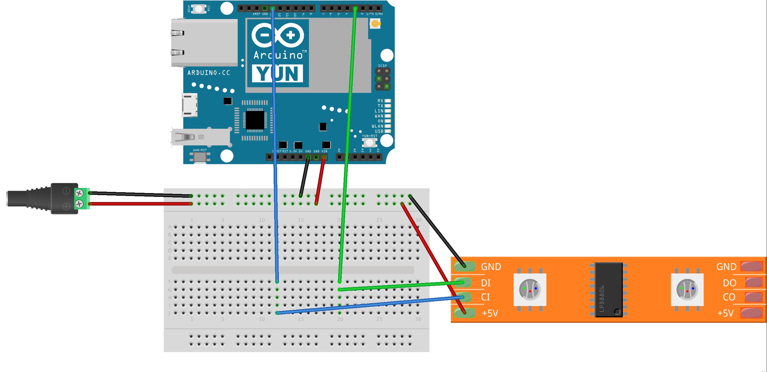

Okay I feel really foolish attempting to post an issue here because I'm a
Okay I feel really foolish attempting to post an issue here because I’m a total n00b and I’m certain that there is a simple answer to my problem. I’ve wired up my LPD8806 lights to my Arduino Yun as in the attached photo:
I can’t seem to compile FastLED/examples/DemoReel100/DemoReel100.ino successfully. I keep getting the following:

Thanks for the quick response @Chris_Parton . I appreciate your insight here. I switched the DATA_PIN definition to the correct value of 3 and I uncommented the second FastLED line (while commenting out the first). CLK_PIN still defined as 13. Even with this setup I still got the same error. :frowning:
Should I reopen the issue?
