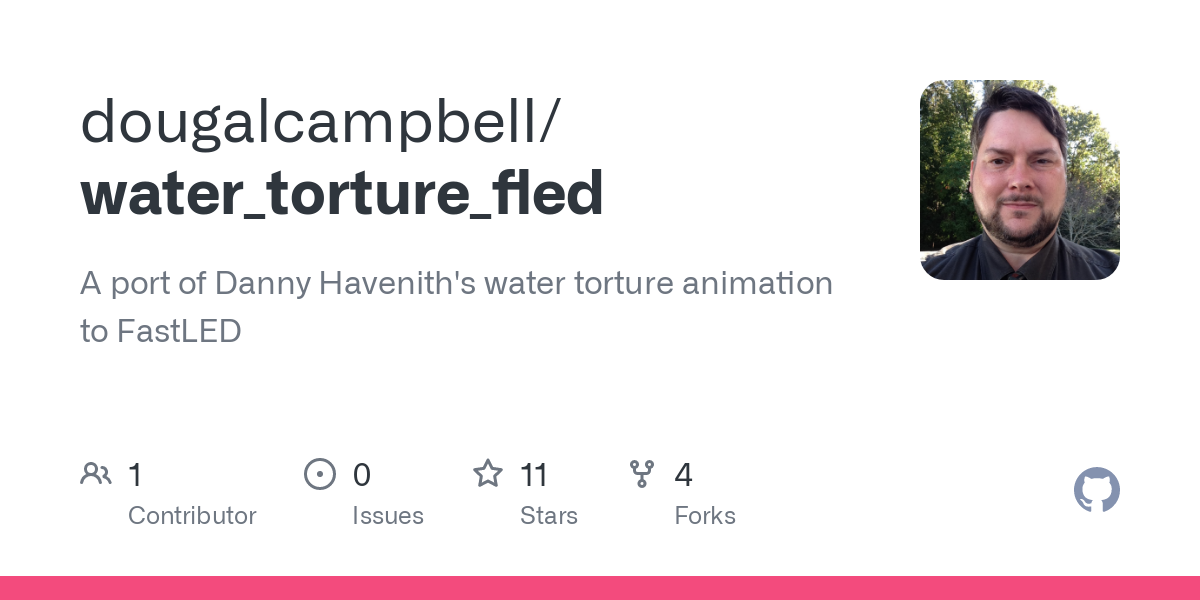

Okay, I got Danny Havenith’s water torture animation ported to FastLED. Source code is on Gitub:

You are too kind – I am not a C++ programmer! I cribbed most of the basic skeleton from ?somewhere? when I did my blinky eyes project for Halloween 2015. Then I figured out how to do the Dependency Injection style of passing an external LED controller reference in by doing a lot of Googling.
I re-used that basic structure for this. I couldn’t figure out how to get a reference to the configured CFastLED object, so I settled for the CLEDController reference returned from addLeds(). And I was really rusty on pointers and references, but eventually hit the right combination of ‘*’, ‘&’, ‘.’, and ‘->’.
I’m sure there’s stuff in my code that would make an experienced C++ coder say “WTF” more than a few times. Most of my work is in PHP and JavaScript, and the loose typing has made me a bit lazy!
One thing I do like about coding the animations as a separate class with an ‘animate()’ method called from ‘loop()’ is that it makes it possible to run multiple animations simultaneously, and layer effects on top (in many cases).
I’ve updated the code to allow each instance to have a custom color. You can also set the ‘gravity’ value individually now. I’ve update the demo .ino to demonstrate two droplets running at the same time, one blue, and the second one orange and with lower gravity.
Note, I also realized that the strip I’m testing with uses GRB color order, so the demo file reflects that, as well. So adjust accordingly for your own chipset.

Okay, I finally got the reverse direction working, and the Github repo is updated. Sorry it took so long, but our household has been busy the past few days. I should probably make a new video…
