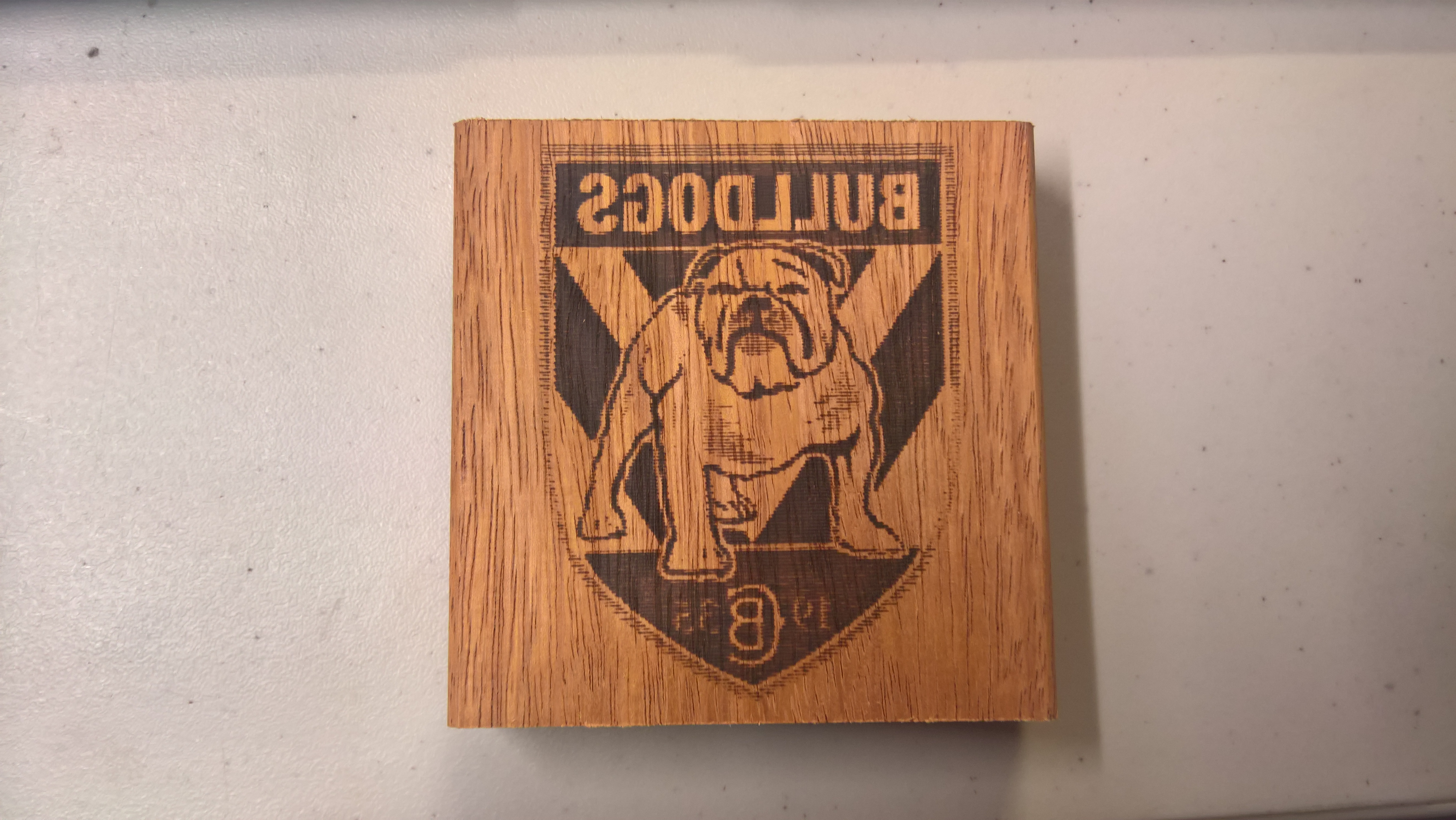

Okay, now this threw me… the image lasered backwards. Didn’t notice with other pieces as there was no text & I was too busy checking the detail level.
Is there a setting I am missing?

Yes, did you invert the steppers and endstops?
@Ariel_Yahni_UniKpty I know I had to invert the X stepper. So it is printing inverted on the X. Is there something I can do to fix that?
On X, Y only. When you jog left does it go left?
@Ariel_Yahni_UniKpty after inverting the X in smoothie config with the !, when I jog left it goes left. But previously jogging left would send it right.
But this has caused the above?
@Ariel_Yahni_UniKpty Not sure if that is what caused it or if something else is responsible. But it turns out all my images are lasering backwards. I just didn’t notice on the ones without text.
