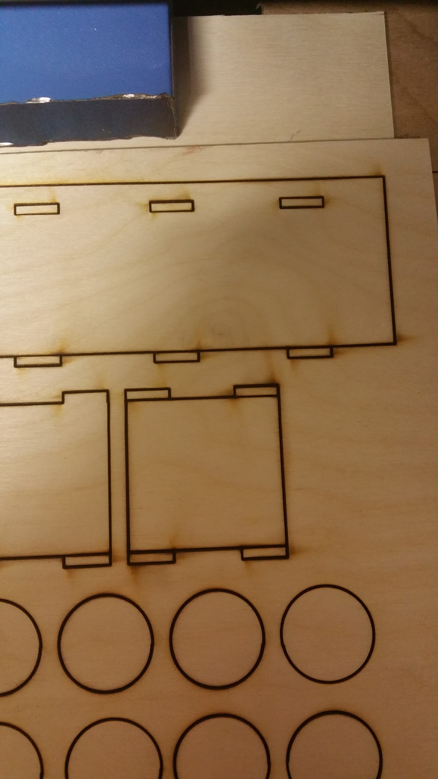

Okay, so I was cutting my first finger joints tonight. For some reason the laser went back, cut them off and then also cut them corner to corner. What the hell?

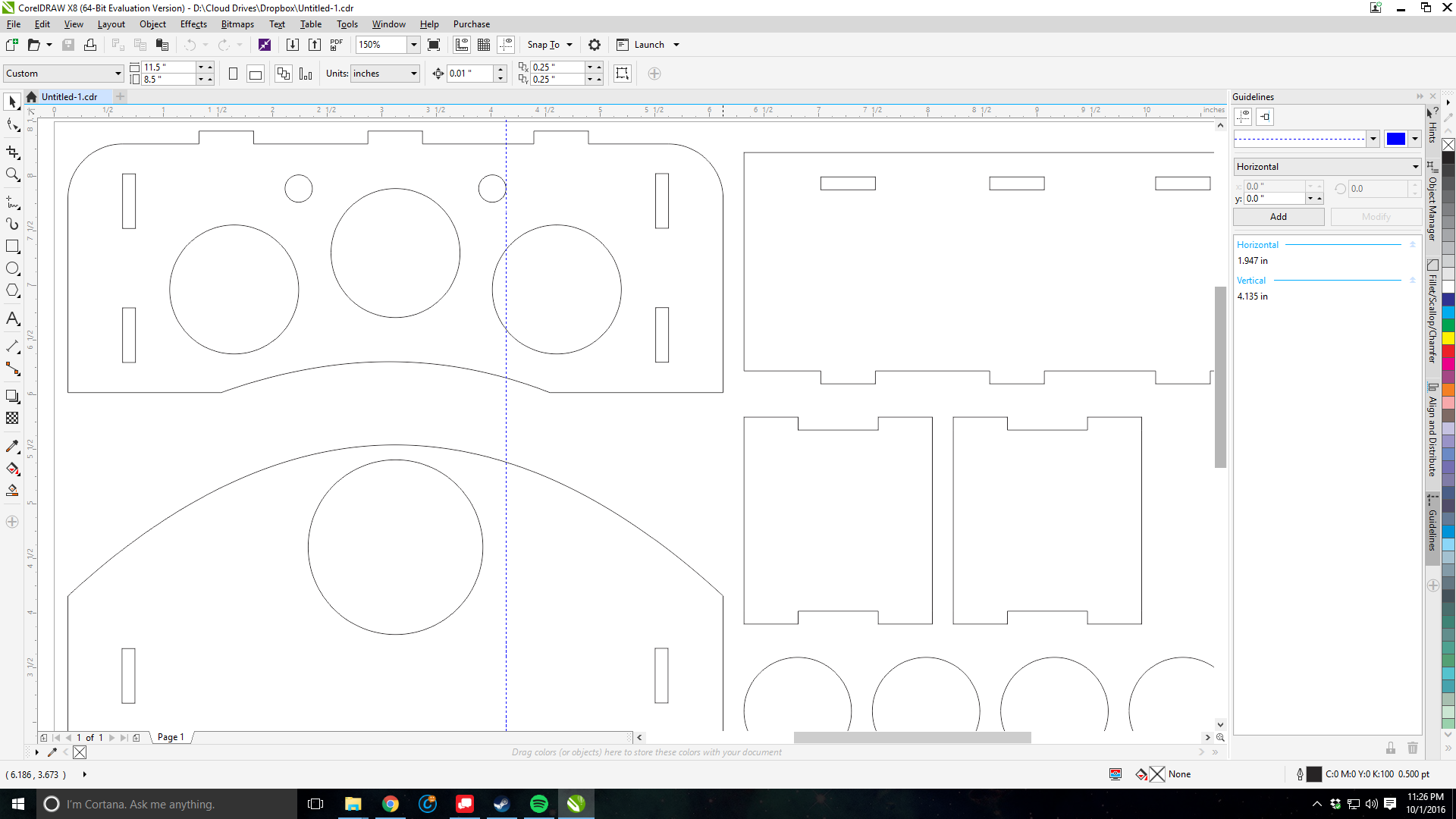

So the software for some reason is trying to close that path. So you need to make it 1 piece
Yeah, paths aren’t closed will be likely the issue. Alternatively look for any invisible lines (i.e. no stroke, no fill) in your file (I had that happen before & it cut a solid line where it should’ve been dashed lines).
Well hell. How do I go about closing paths? They are node to node.
Nevermind, I found it and you all were right! Thanks!!
