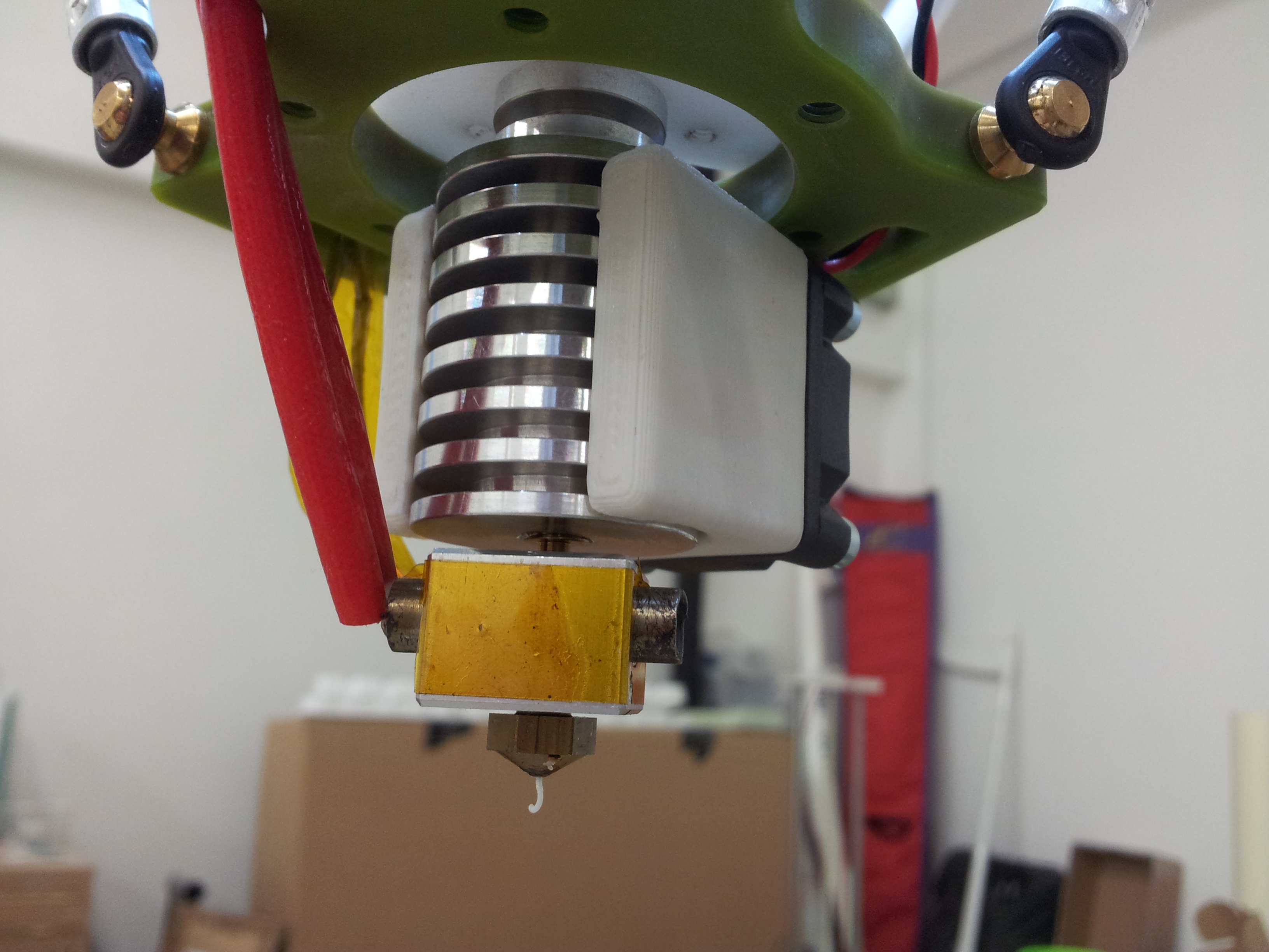

Okay, so I ordered the “no fan” version, not becaose Im cheap, but I was in a hurry to get mine and this option was promissing next day delivery. In order to prepare myself I printed the fan mount from ABS right away from the provided file. Of course, first thing I tried was putting the fan on when the nozzle came and it went right on with no problems. Okay, first step done.
I didnt made the holder, although the E3D provides measurements online I decided to wait for the hotend and do the measuring myselfe. And man I was right, I dont know if any of you have had the same expirience, but the shoulder for attaching the hotend to the holder is 5,5mm instead of 4,6mm stated on E3D download section. Also the most upper 16mm ring is not 4,7mm, but more like 3,5mm (speaking from my head). This is really not a big problem and is really the only thing that I hold against E3D, but would be really useful if these measurements were spot either on techincal drawings or the machinig itself, so we dont get suprised when we want to mount the beautifull piece of metal.
After I got the correct measures, I printed myself a holder from 618 and mount it, I wont talk about assembly, the manual is really straightforward and the hotend comes together with really no fuss at all.
So lets start extruding. Oh my god, this thing really works! I have had previously a J-head with 0.4mm nozzle so this would be in theory just a replacement with wery little to no calibration. And man I was right, the only thing I nedded was a little increace in my flow and we we have a rocket. This nozzle works like crazy, it is wery precised, I was really amazed of how precise the corners can be, and basically all was working like it should. So you can find in the pictures the comparison of the J and E3D hotends, the fan on the right is done with V4. I need to point out, my J has around 300 hours of labour behind, was cleaned a coule of times…
