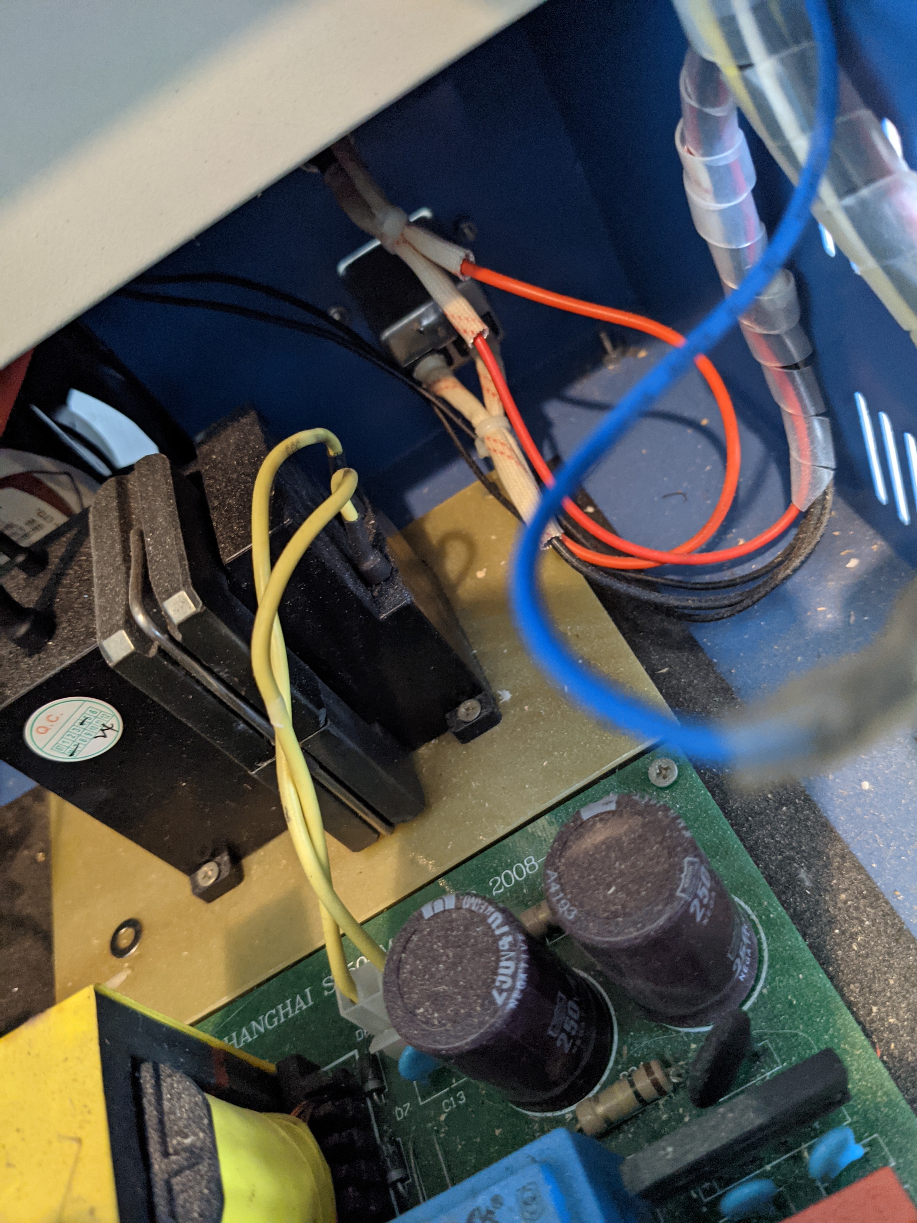

OLD PSU wiring diagram
Hello Bought a used K40 and it has a old PSU I would like to upgrade the PSU but a wiring diagram would help out a ton and a link for a $$ friendly PSU that will work on my k40
If someone has the diagram or has replaced this PSU please help if you can

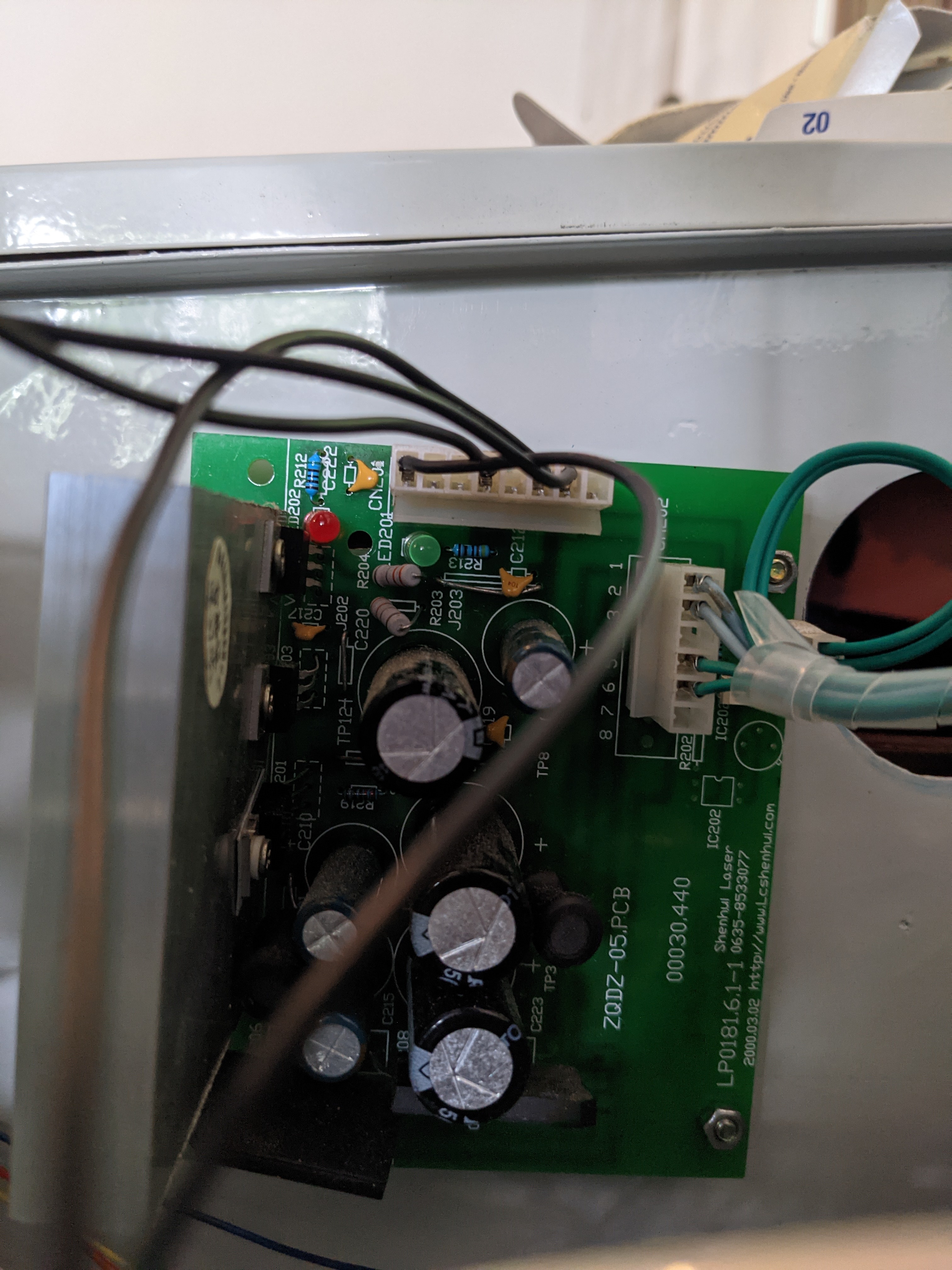

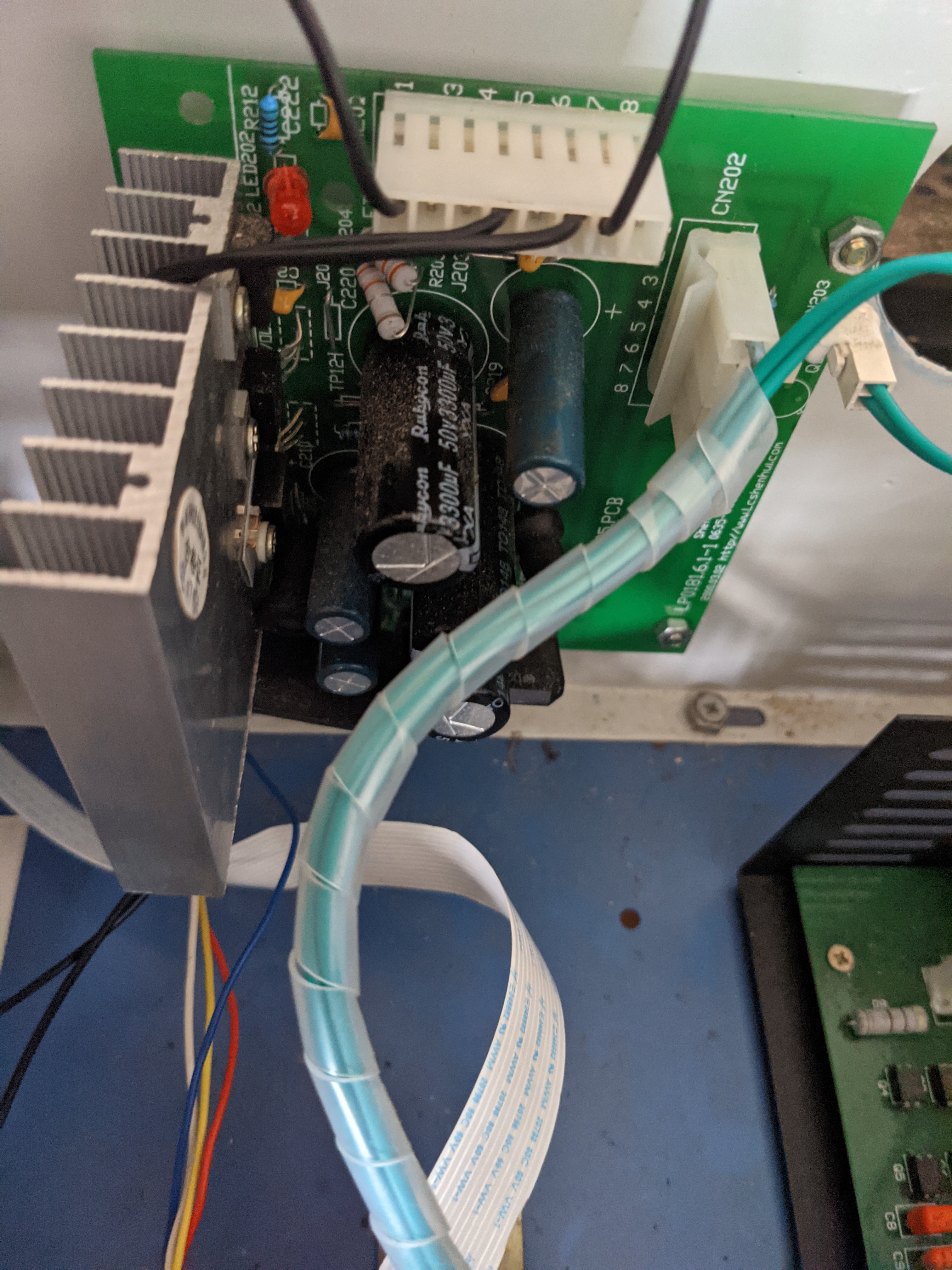

It’s likely we can help.
Need a picture of the connectors on:
  • The LPS (picture 3)
  • The supply on the wall showing the labeling on the front edge (picture 1& 2)

What is that metal can in lower part of picture 3
From this we can create a wiring diagram for you.
We can also choose a new LPS.
So I know how to prepare this info:

We might be looking at one of the earliest K40/K50 lasers. The name on that left wall mounted board is LCShenhui and they don’t exist any more but a few forums ask about them back in 2010.
I’ve looked at this pics a bunch and best I can come up with is that they had separate HV PS and LV PS and what we see is the LV PS transformer at the bottom of pic #3 and the board on the left wall is a 24V/5V power supply. As you mentioned, a few more pics and info might show how things are wired thus exposing what they do.

Looks like the green terminal block is AC distribution.
The metal can is actually a transformer, perhaps for a linear LV supply. But its output does not seem to go the sidewall mounted supply.
The LPS inputs are not labeled on board.
The green thing is a ballast resistor that is not needed with a new supply.
