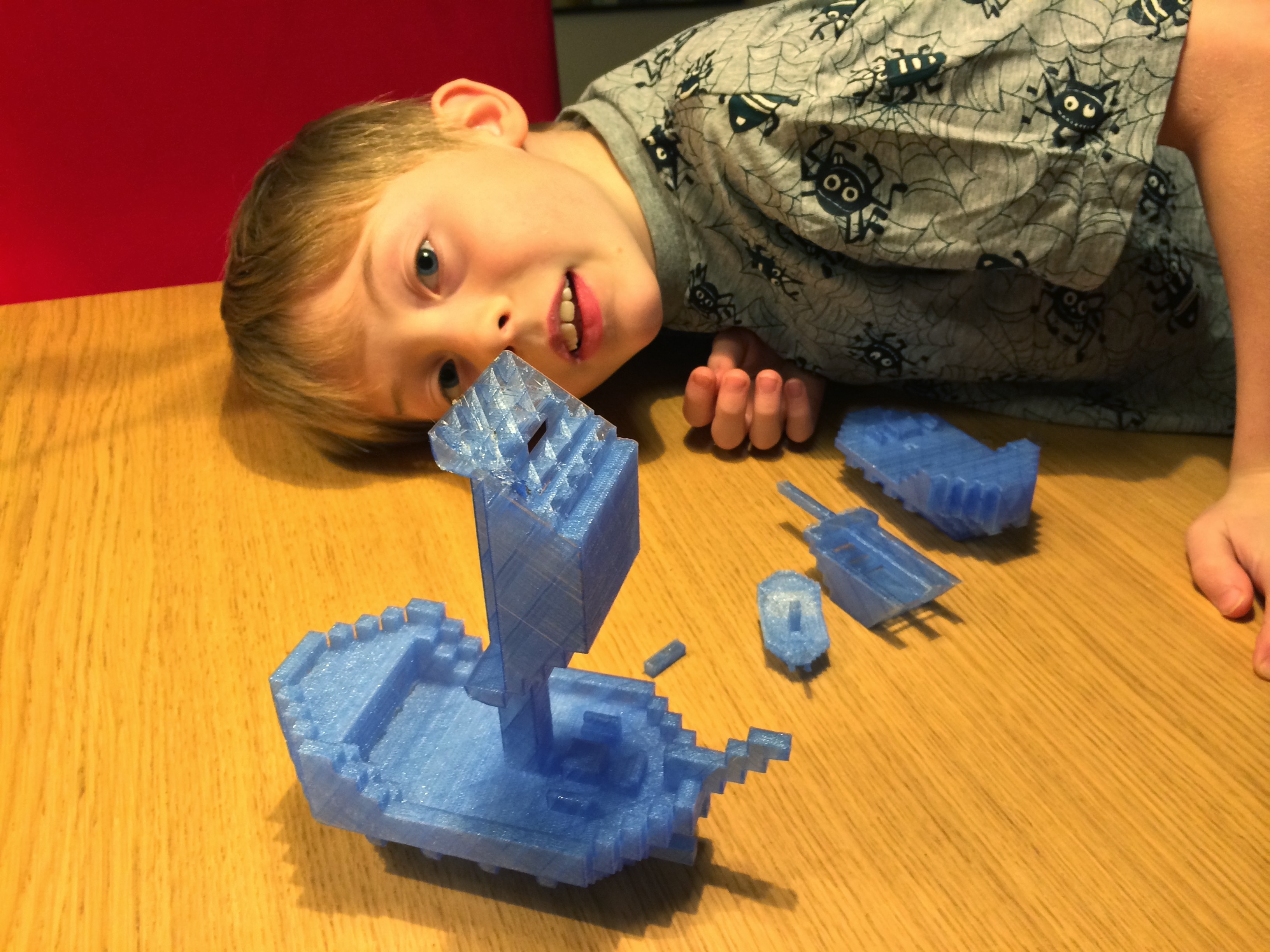

Oliver (my son, 7) designed his own ship in Minecraft but all those 90-degree
Oliver (my son, 7) designed his own ship in Minecraft but all those 90-degree angles aren’t easy to print. This one is printed at 45 degrees (by cutting off the “butt” of the ship) but still not that good (my son is becoming picky with his prints). What I would like to see is a tool that transforms a Minecraft-model into something more soft and by that makes it easier to print. Any ideas?

Have you spent much time using supports in Cura? It does a pretty good job once you’ve adjusted to settings in expert mode.
@Tim_Rastall , no not really. I find the work after printing with full supports a bit tedious :wink: BUT perhaps we should give it a try. By the way, any suggestions on what to change from the default settings for support?
I find the horizontal gap can be smaller than default, as low as 0.15mm and the Z gap can also be reduced a touch, it seems these settings are very specific to material type etc so some experiments may be necessary to get it dialled in :slight_smile:
Ok. Thanks!!
Tired with http://www.thingiverse.com/thing:37351/#files and have more soft result:

Supports aren’t really suggested for PLA since they bond too well. If you can play with dual extrusion, try water dissolving supports. That way he isn’t limited in his designs.
Yes you are right but dual extrusion is just too much work (plus I never got dual-extrusion working very well on my Ultimaker1).
