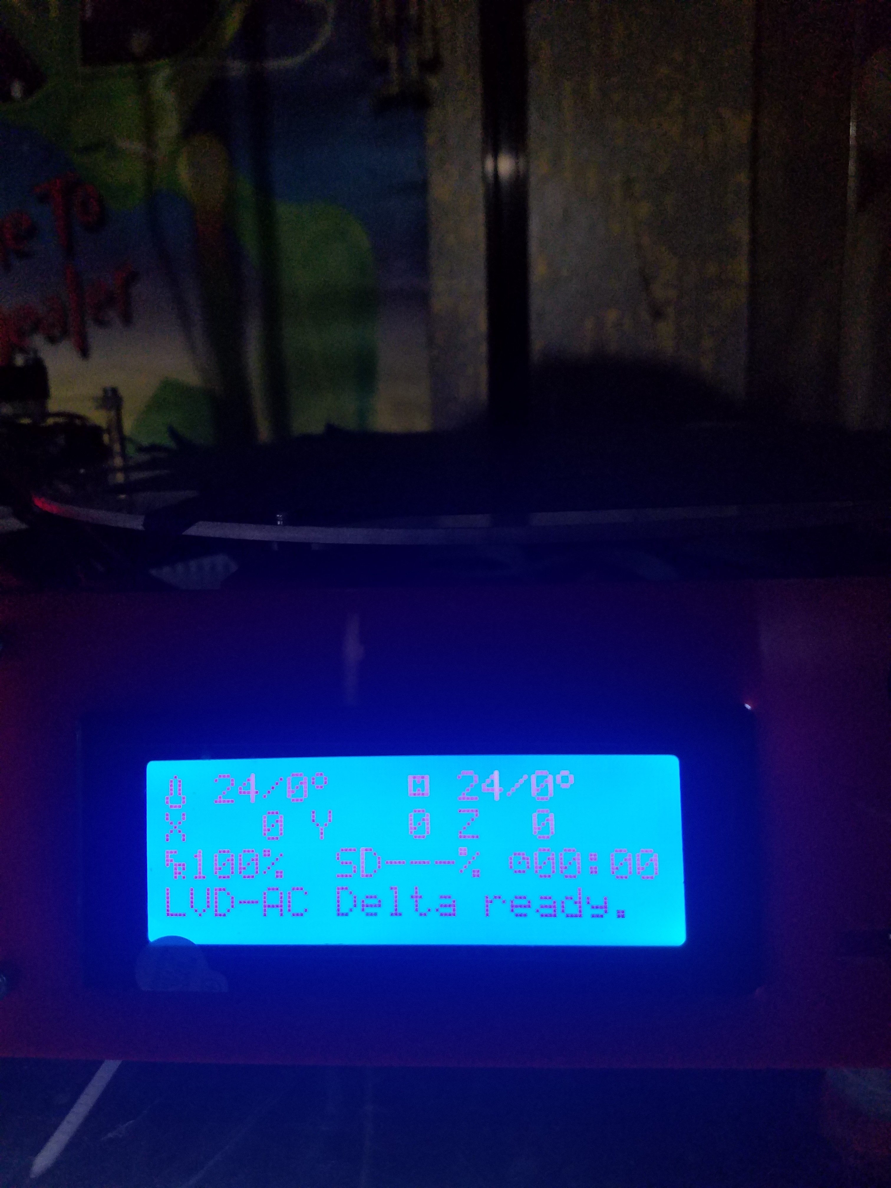

OMG! I have a screen, this printer has been down for so long,
OMG! I have a screen, this printer has been down for so long, I don’t hardly know what to do,
Does it have a z probe? If not, try to make sure your nozzle has the paper gap right around the bed with hotend and bed heated. Check belt tightness. Check tower angles. Do a cold pull just for the sake of it. Delta calibration prints.
@NathanielStenzel yea, it has a z probe, I entered recommended settings in marlin? I did the calibration and auto level. I got it to connect with cura and tried a test print, the head took a dive into the bed? Lol. But when I tried entering the calibration settings in marlin, I ran into a com port issue? Then I noticed my internet was down and my com port was saying it wasn’t functioning properly. So! A few hours later… found the problem with the router and got the internet back up, fixed the driver issue, I found that it didn’t like the usb port i was using? And finally started a test print! First layer looked like shit, still have some tunning to do! But after two months of waiting on parts and programming, my kossel is working! Now on to the ender? Then the da vinci!
What material, bed temperature and first layer height? I printed ABS with 100C bed and 0.3mm first layer height (nozzle set 0.1mm low for extra squish) and 0.2mm for other layers.
Good luck with the Ender.
@NathanielStenzel this will be a dedicated pla machine for sculptures and figures. The print I started was at 195, 40 and 3mm. Yea, bad settings, I was just looking for function
