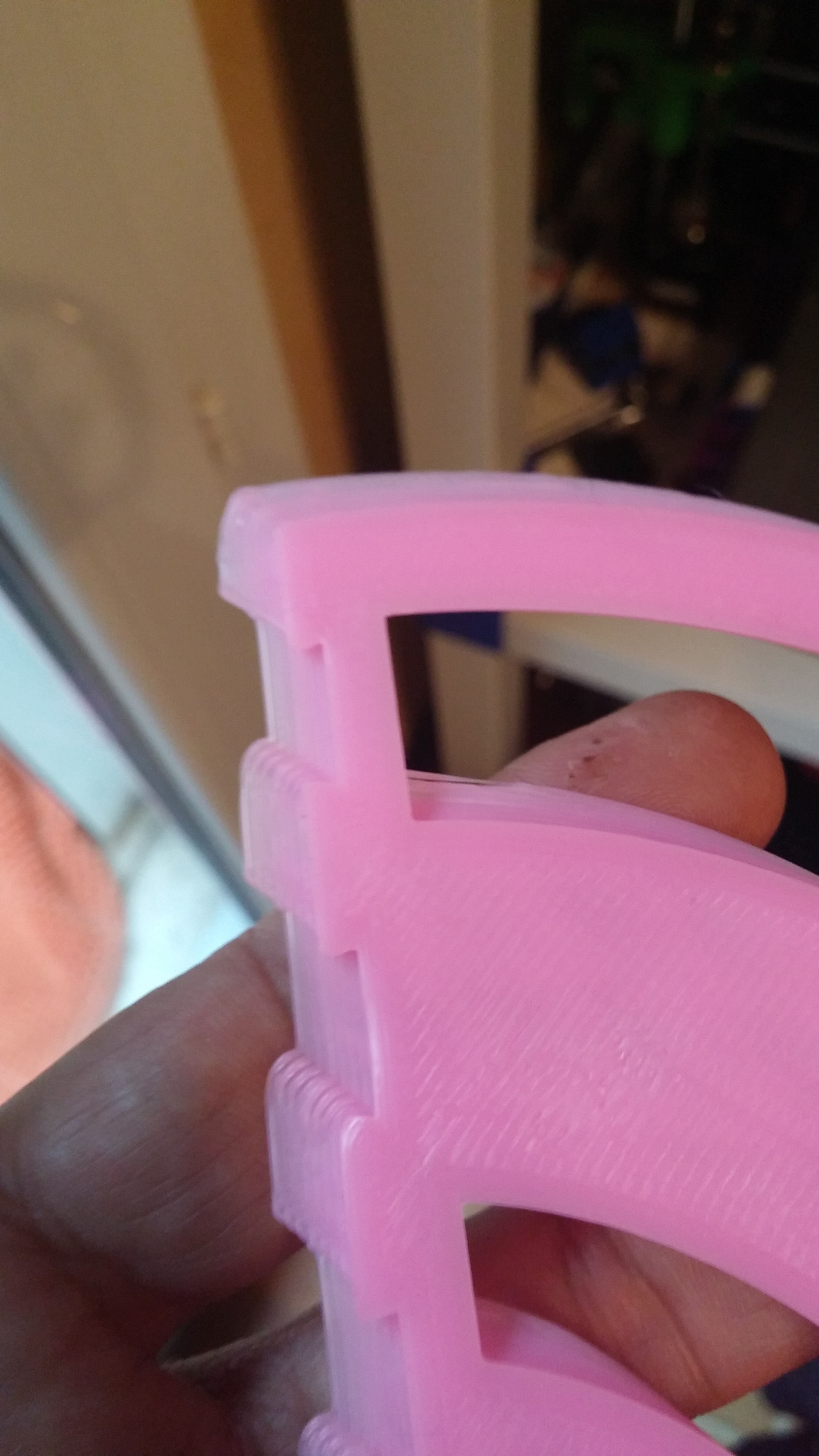

so better with old version, i can do with acceleration at 0.8 and djerk at 0.02, but now with djerk at 0.02 i have layer shift at 3rd ou 4th layer
@Jon_Charnas the printer do 2 or 3 layer, and after that, it print with a shift and continue as nothing happend

The layer shift sounds like skipped steps, and it can be difficult to find out the exact amount to go in current… I’ll get Wiley to look at your reports here, since he’s writing the path planner

@Jon_Charnas i have tune up the current, but same. but i seen to be more than a layer shift. with old version, i have acc at 2 and djerk at 0.02, i dont notice this issue.
Ok, noted. David reported much the same to me on Slack. I’ll communicate with Wiley (the path planner wizard) and we’ll see what we can fix there.
