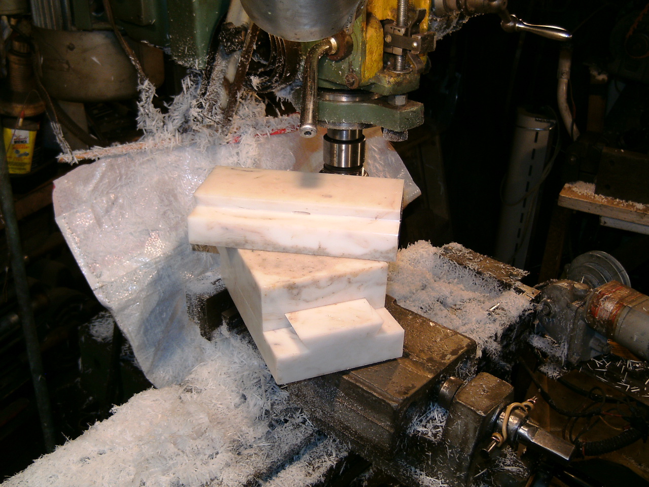

On my mill it is beginning to look a lot like Christmas. That’s just what blow molded HDPE shavings end up looking like. The second time was a charm with this dovetail stage I cut out here.

Thanks. Yeah this one has a good feel to it to me. The first one was too tight, then I cut it once more, and it was too loose. A couple thousandths either way makes it, or breaks it. The rest of the machining I need to do with this is not nearly so close tolerance. I need to dig a pocket in the female to accept the lead nut. Then a channel for the lead screw. That is all it is what it is. I got plenty of meat to work with to make it all happen. I guess I can still screw it up. But I’d have to try really hard to manage it.

cat litter actually. It stops some of the chips from spreading around. You should see how I have the table setup when I am just milling blocks. But to do this work I need to see what I’m doing.

I usually use the bags as garbage bags in my shop. But I have more for that than I really need. So I come up with some other uses for the bags. They’ve basically the same thing polyethylene tarps are made out of. Just a lot smaller.
