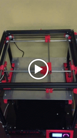

Once I set the microstepping to 1/32 instead of 1/2 (oops) I was able to run the break in g code. I’m having trouble though.
Got any suggestions?
looks like your alignment isn’t as good as it should be. Alternatively try putting a bit more power into the steppers.
Ouch.
Your binding in the front portion of the machine. Move the carriage to front and loosen and tighten the bearing block screws, there should be no tension moving the carriage at all corners. You might want to disengage the stepper belts to feel any friction.
I tore it all apart. It definitely is sliding around really easy. I have this vibrating issue now.
I got it working like a top! The belt on both directions was off about a tooth or so from left to right.
