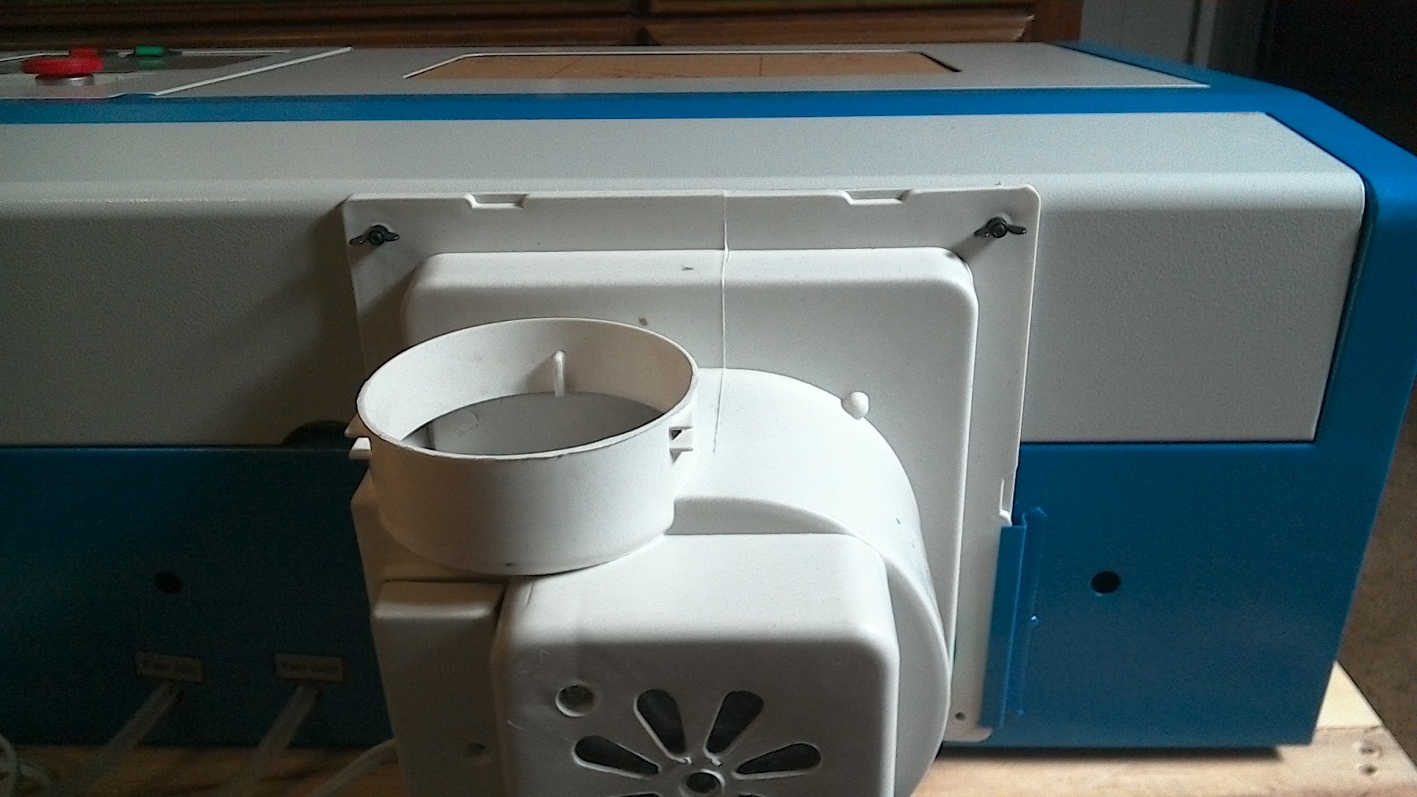

One last little mod before I move the new K40 to the shop. I poked a couple of bolts through the laser tube cover and glued them in place. Next, I attached a foam strip to the inner edge of the fan housing, slid the fan in place, and secured it to the bolts with a couple of wing nuts. From what I can tell, it’s pretty much sealed in place now.
Time willing, tomorrow it goes to the shop, water gets connected, and a test fire will be performed.
I’m in the process of designing an adapter for using a standard dryer exhaust booster with mine. all 3d printed.

I like the idea. But how do you slide it out again? Can it go over the bolts?
If you use the original fan: make sure the nut holding the fan is tight. Mine got lose and I had to glued it on the axle.

I find that the oem fan works great, I am using a custom duct. My duct was too long and I wanted to shorten it, but mine was trapped in the machine and wouldn’t come out. I cut it apart in-place with tin snips and removed the chunks. Then I installed M4 nutserts in the K40’s cabinet and 3d printed a new duct that installs from the rear rather than from the inside. I’m using the original fan with a piece of tape across the top so that it doesn’t sag and it works perfectly.
@Corey_Renner I find the stock fan only draws out the smoke when cutting along the top half of the bed. Any cutting being done along the bottom half of the bed, the smoke will just rise into onto the laser head and around the case.
I too tape along the top of the stock fan to the case so there is no vacuum leak there and only have a short length of vent.
