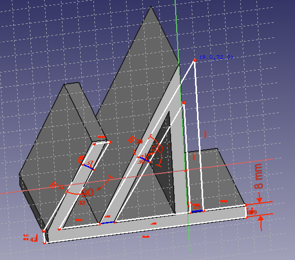

One more image for YODA KNIGHT  before I get on with Dinner :) and
One more image for @Lotfi_Leviaton before I get on with Dinner :slight_smile: and the VAT return :frowning:
It’s not obvious but while in Sketch mode you can still rotate the view around, resize/reshape the sketch and see the changes to the model as you go. It’s why I think some simple tasks are better in FreeCAD than OpenSCAD, you can get immediate feedback, not have to adjust-render, adjust-render. But there are some complex shape’s you’d be mad to try in FreeCAD instead of OpenSCAD. It’s just a matter of the right tool for the job at hand, just as most people wouldn’t put screws in with a hammer.
