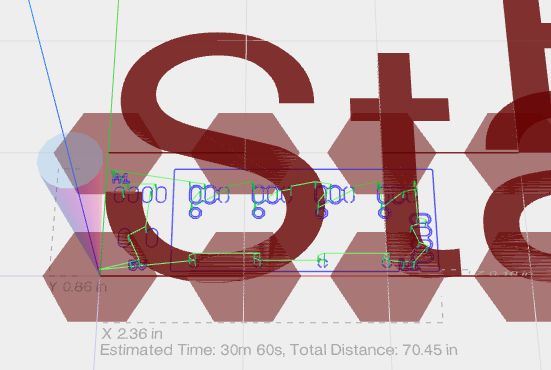

One more issue. Sorry guys. Here is a screen shot of what the auto level looks like. It is running 2 probes on the Y axis at a 1mm spacing and 4 probes on the X axis at 1mm spacing. My gcode file is in Inches and is about 1 in by 2 in. Is there a way that I can change the units of my gcode or of the Auto level tool so they are both in the same units?
If you fork the widget and tweak it I don’t think adding support for inches would be that bad. Maybe add a radio button for units and toss in a g21 to the gcode sent to the controller and you might be golden.
