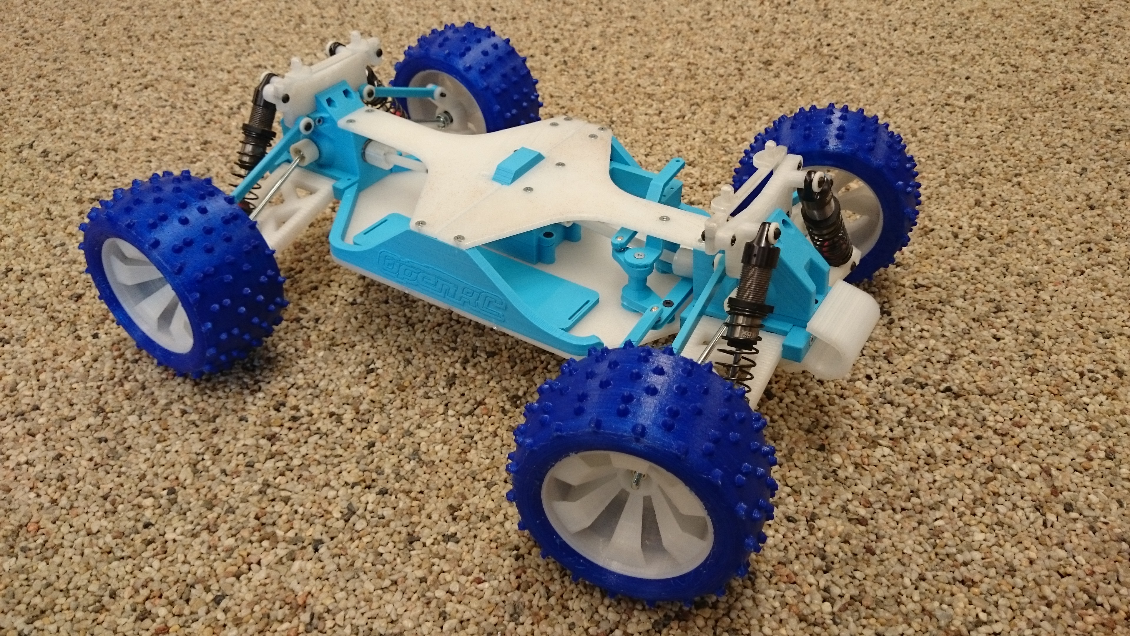

One more OpenR/C Truggy ready for electronics!

what driveshafts did you use ?
@Jarek_Szczepanski 3dprinted in taulman3d’s tritan. But I also use Polycarbonate for the driveshafts…
damn… I meant CVD driveshafts
Oh, sorry! =) It’s the ones from http://www.conrad.com that been discussed before, I don’t have the link right now, sorry.
My mistake, sorry. I’m still fresh with this all RC terminology :slight_smile:
I’ll try to find them on http://conrad.com but I’m pretty sure they are more expensive than chinese ones :slight_smile:
Looks fantastic! Can you give us a breakdown on what materials you used? I’m guessing most of the white is a Nylon of some sort, and the blue is ABS. Is that correct? Did you print this on your new ZYYX?
It’s Nylon 645, ABS, NinjaFlex, PCTPE, Polycarbonate and Tritan. It’s printed on a 1st Gen Replicator and a 2X.
@Daniel_Noree Thanks! If you get the chance I would like to see a run down of what parts you are printing with what material. That should help newcomers like myself when they are debating on what material to use for certain parts. Also, do you prefer the Nylon 645 to the Bridge Nylon?

@Hampus_Liljedahl All my electronics are from Hobbyking, screws are from “Sifvert Skruv” in Västberga. Bearings are from “http://kullagergrossisten.se
@Adam_Thole Taulman Nylon 645 is stronger than Bridge, and so i prefer 645.
Can you give more detailed measurements for the Reely parts so it easier to find alternatives. For example the CVD’s. Yes they say 118mm length at Conrad.com but what is the diameter of the hub and axle. Also what is the length of the hub by itself?
