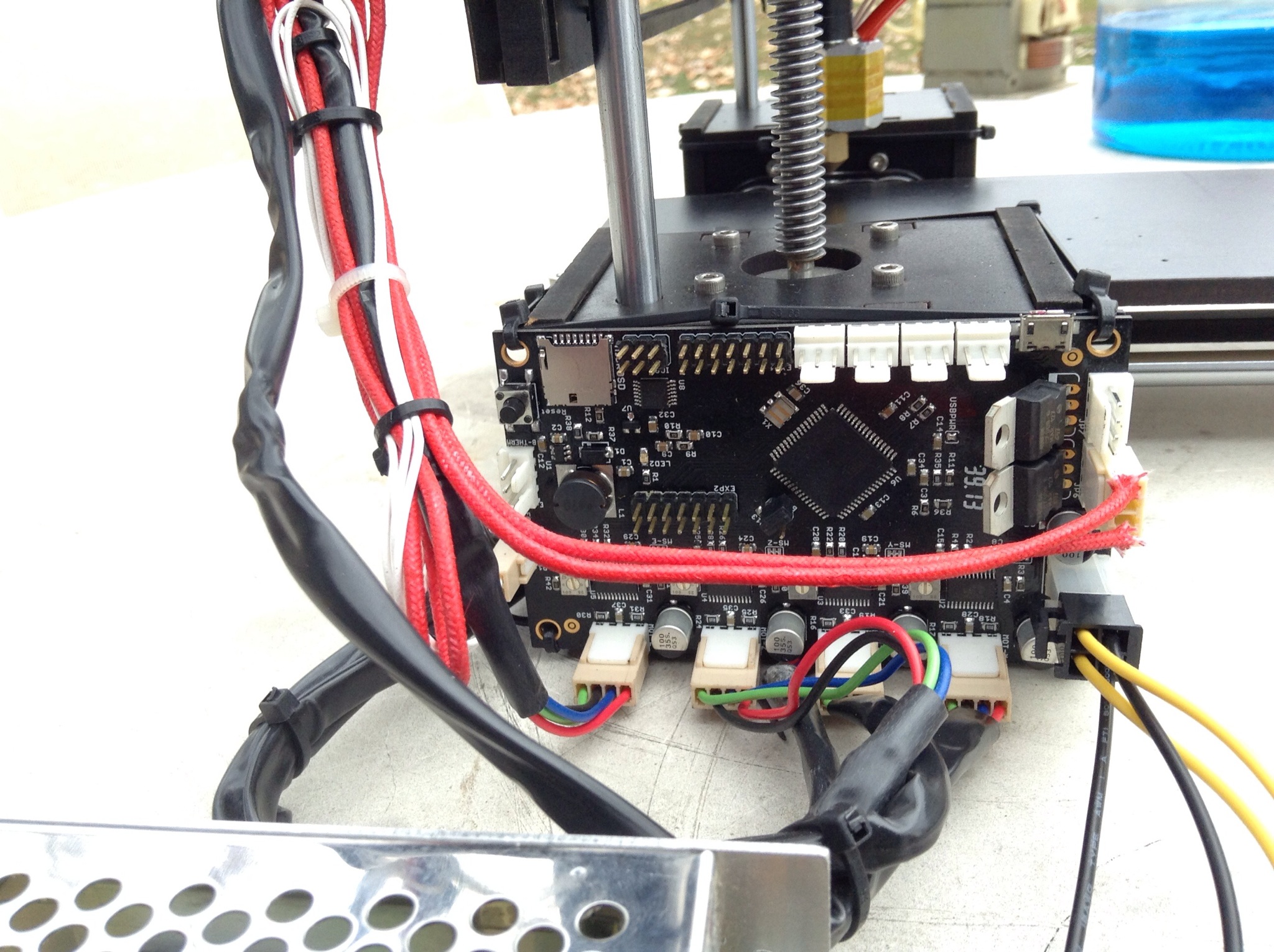

This is the current progress of my first 3D printer, the One-Up from QU-BD. as you can see, still no X-Belt. I also have to yet applied any power. I was wondering if this would support a VIKI controller.
Also notice the Y-Belt. It seems a tad bit snug on its inside track. I’m not sure how well I’ll be able to adjust for that without taking the whole thing apart. I’m hoping that I will have room inside of my modified belt clamps to compensate.

Something I would do if you’ve got soldering skills: Reflow the solder on the 2 FETs, so you get a small amount of solder flowing through to the top pads. the drive FETs (specifically for the heated bed) pass a LOT of current, and the better the contact there is between the pins on the FET and the pads below them, the less resistance.
Also: Make sure you have a fan (eg: 40-60mm) pointing at your electronics. The FETs get warm/hot, and also the stepper drivers. Keeping them all cool means it’s more efficient, plus stops the stepper driver temp limiter cutting in during the middle of the print.
PS: Be careful of metal getting around the back of that PCB and shorting stuff out.
As far as the bottom of the board, I have already taken a measure to help. I mounted a hard plastic frame that doesn’t interfere with any of the soldered joints.
As for my soldering skills, it’s not like bike riding. The last of my pro skills were used back in the 80’s. I think I need some practice before I hit my own wallet with an overheated component.
And I do have a couple of spare fans but I’ll have to figure out a shroud or mount I guess. Thanks for the advice @Stuart_Young .

@Rojer_Wisner No problem. I used a piece of acrylic plastic for a fan bracket on one machine. Heated it up slightly (hot air gun) and bent it over the edge of a piece of wood till it was the right shape. Still had to put a hole in it for the fan (did that first) but it holds it nice and secure, and the air blows where I want it. :smiley:

Aside from the viki not being compatible, as @Eclsnowman mentioned, start out just getting the thing working, then add the fancy stuff. I was a Kickstarter baker of the viki, and tried hooking it up to a sang board, as it claimed to be compatible to. From the frustration of getting the thing wired correctly and software coded correctly, I accidentally connected out to 12v man’s instead of 5v. The pins are right next to each other and are very hard to see on my printer. Needless to say, the viki makes an expensive smoke machine. But lesson learned, take it slow, for your sanity and your wallets sake. Good luck
