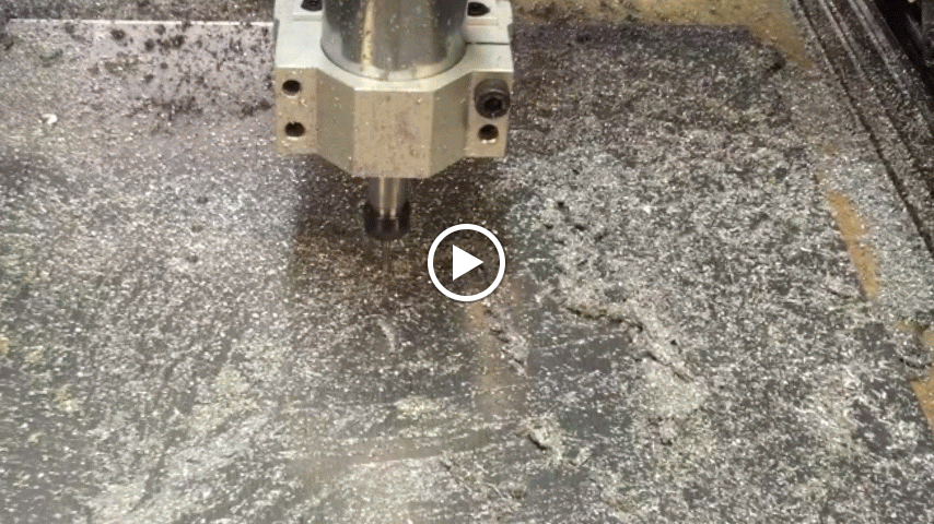

One more try at uploading this video of my first run at using @jlauer 's Chilipeppr. I’m still “fiddling” haha with the buffer, but ran a couple of big jobs on it yesterday. Every time I sit down with this I learn about some feature. Really excited.
Shown with a dry run, 4mm tool, 10kRPM.
I think you have almost exactly the spindle I have.
It’s the 400w from the site. It does have a dedicated 48v power supply.
You know… You could mimic the mount I’m using. I had to tap holes in the mount, and the extra piece of 20x80 causes a slight more moment arm than I like, but it works.

What spindle is that
400w 48v from the site. Power supply to match. I’m pretty happy with it I would like to have more torque, but looking at expanding the X axis and the weight cannot go up much more on the 20 x 60.
Cutting Aluminum is how I do it.
Nice. It looks like you’re getting ok sized chips. Do you use coolant or lubricant?
I use coolant.
