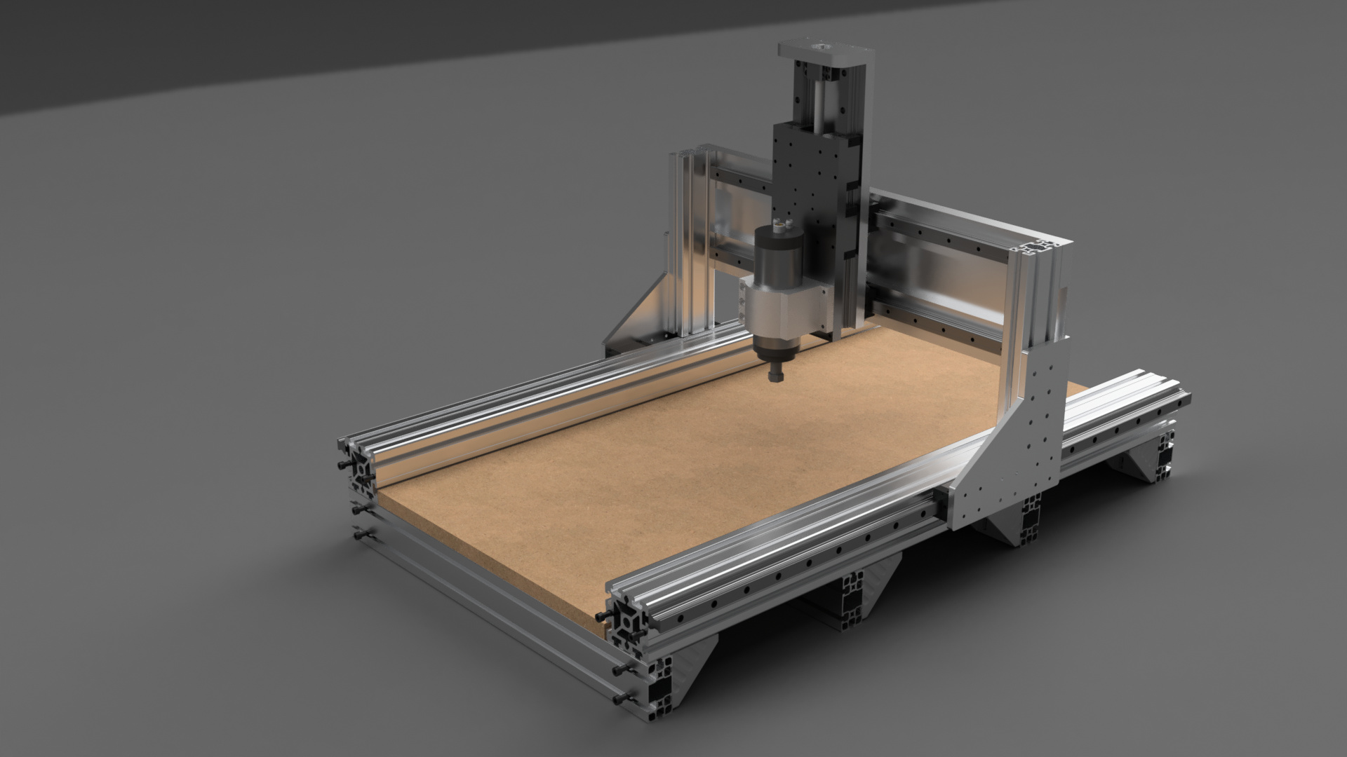

One more update on my DIY CNC project
Most of the z-azis is ready.
20x150mm alu plates
25mm rexroth rails and blocks
450mm 1605 ballscrew
20x150mm alu plates
Y-axis ready. I consider using a simple cover to protect the screw… from dust…
Y-axis done, X-axis next
