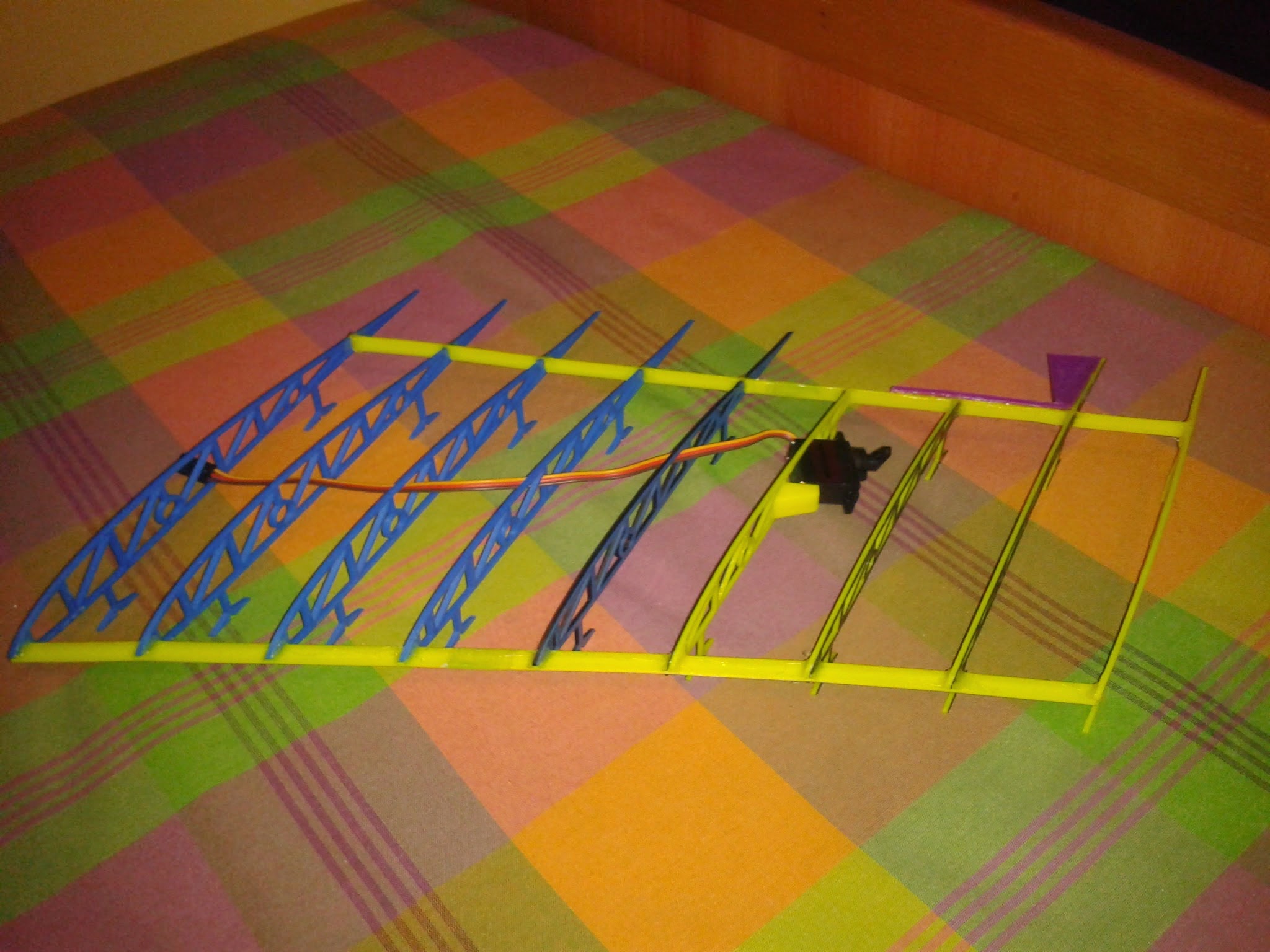

Starting to build openswift from @Andre_Roy .
It’s just the left wing, and right now I’m just going to try different systems for covering (I’m not a fan of covering with balsa, and I think we should try all the ways for covering we can), it’s going to take a while, I don’t expect printing and assembling the right wing until feb2015.
Just in case you (@Andre_Roy ) read this lines, the stl’s you provided are really wrong :frowning: , I mean, some parts are oddly rotated and others way out of scale. For example I had to cut ~30mm of the elevon to fit it in place. People who use slic3r as slicing tool need the stl’s properly rotated and scaled, if there is no inconvenience I’ll put them in place and scale and publish (or send them to you so there will only be one version).
Still an absolute impressive work and I really thank you for sharing (it looks sooooooooooooo cool).

I just published a revised (and customizable) version of the spars, made with openscad. Right now is at: http://www.thingiverse.com/thing:608764
I’ll upload them to github and pull request in the original.
