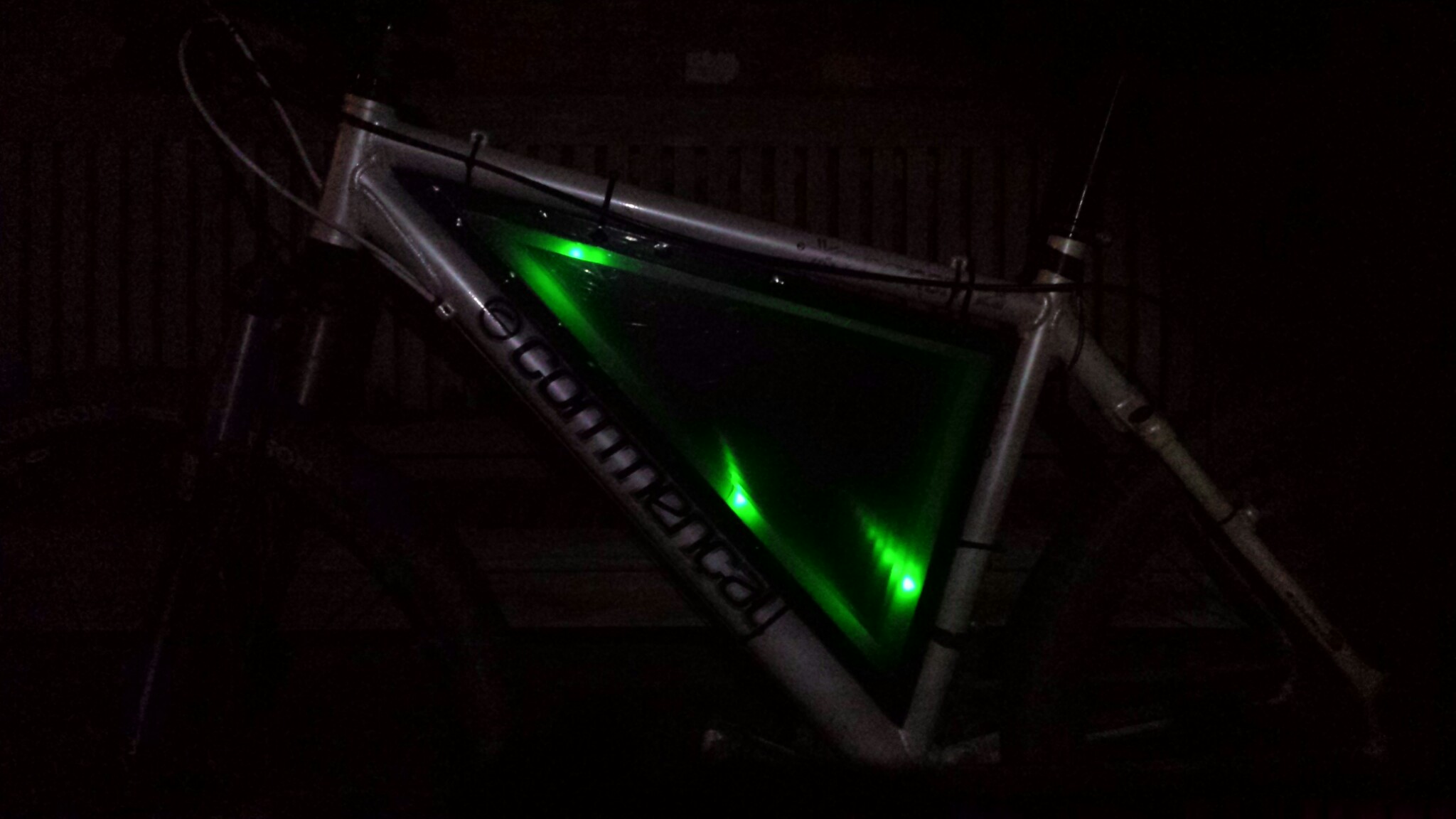

One of the fastled projects for the Halloweennachttocht Zele 2014 (mountainbike nightride in flanders
One of the fastled projects for the Halloweennachttocht Zele 2014 (mountainbike nightride in flanders fields and woods, last year > 900 participants).
A doublesided inifinity mirror mounted in the frame of the mountainbike, 72 ws2812b powered by nano and 14v batterypack. Pixels defused with drawing paper. Currently running the good old funboxing effects.
Not that nice pictures. But viewabel from both sides of the bike and 7 to 8 reflections deep
For sure the organisation s bike will be noticed this year :wink:
