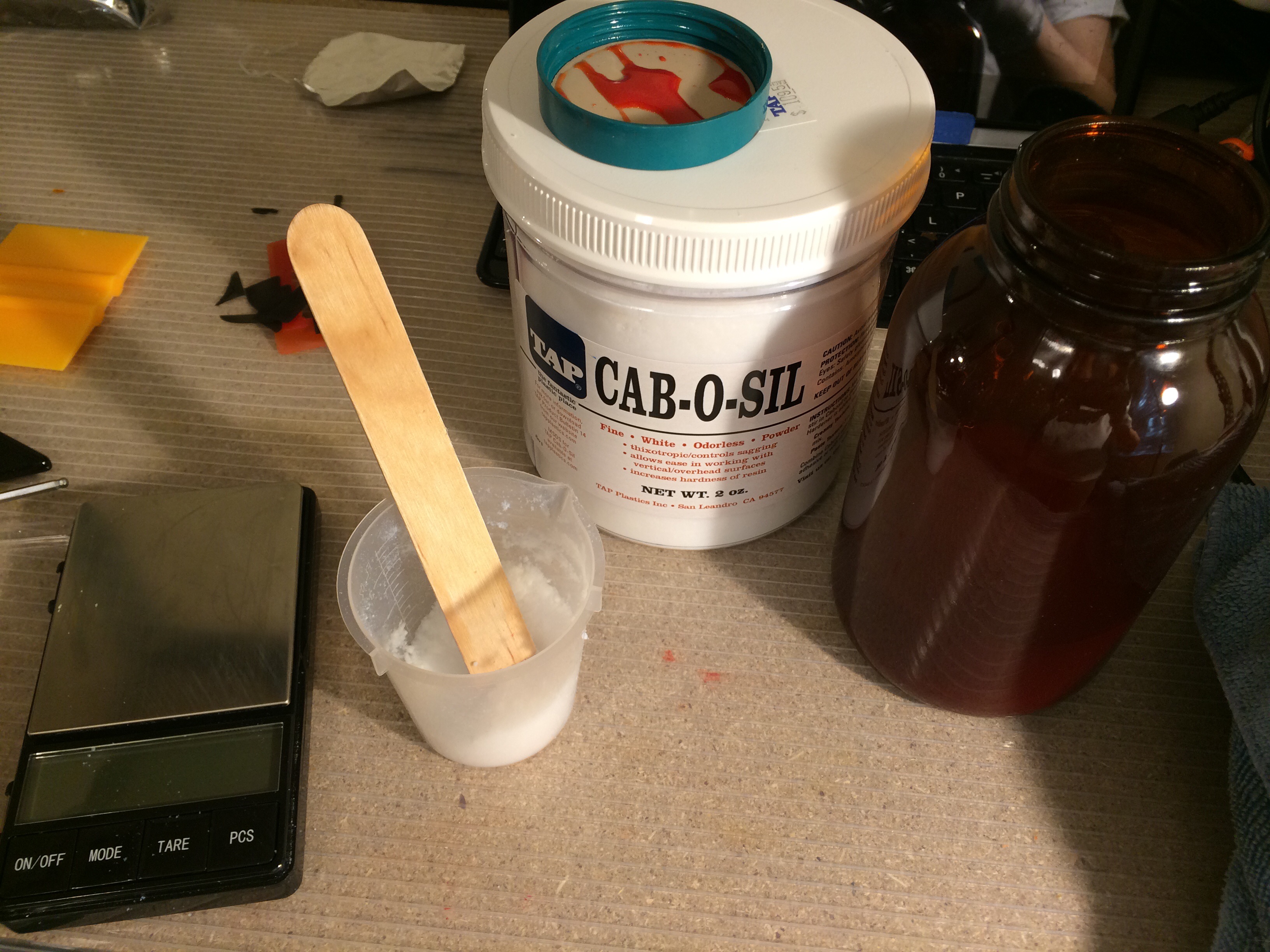

The FunToDo Standard Blend resin is fairly soft (Shore D 30) and presented a better medium for experimentation with strengthening and hardening fillers than the MakerJuice G+ (which is very hard and I would have to test more around changes to its impact resistance given that I have no testing tools). I added 5% (by weight) of milled glass to try to increase strength and then 1% (by weight) of cabosil to make the resin more thixotropic to reduce settling since the milled glass is fairly heavy.
Cabosil could probably be used on its own to increase thixotropy when using powdered pigments in low viscosity resins, although TAP plastics pigment and FTD resins together settle very little even with no additives.
