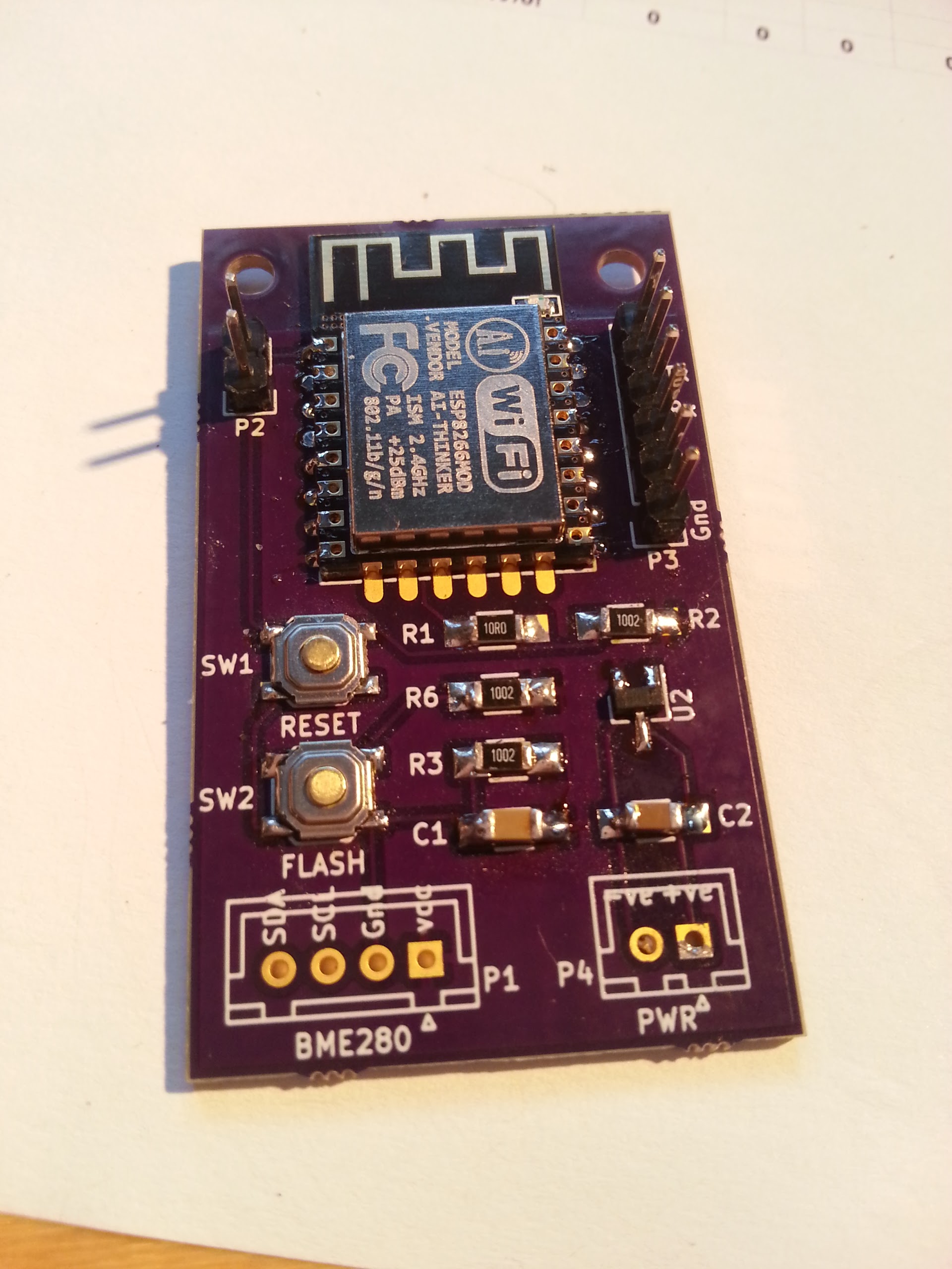

One of the new boards I got from OSH Park yesterday.
One of the new boards I got from @OSH_Park yesterday.
My Environment Monitor project is pretty much all soldered up. Unfortunately I ordered some JST XH connectors and tails from Aliexpress late last year and they have yet to arrive so will can’t properly finish the board.
I did tack some leads on and supplied power and I got 3.3v in all the right places :slight_smile: and the switches worked so it should be fine.

aren’t the mounting holes too close to the WiFi antenna? Better use plastic screws then.

@Petr_Stehlik It will be plastic. Probably just like a couple of small “pegs” which will be [3D] printed into the case somehow.
What made you choose to add all the flashing hardware to every board instead of keeping it in a separate one?

@Richard_Vowles Because I could :wink: Also I have no way of flashing the ESP without first soldering it to something… So why not solder it to the final board? It also means I can update it easily when I find bugs :slight_smile:
Did you solder it by yourself? It looks very professionelle
@Stefan_Kruger Thank you! Yes I did hand solder it :slight_smile: With the help of my reading glasses, a very fine tipped soldering iron, very fine solder (<1mm dia) and a large magnifying glass on one of those “Helping Hands” small clamps.
