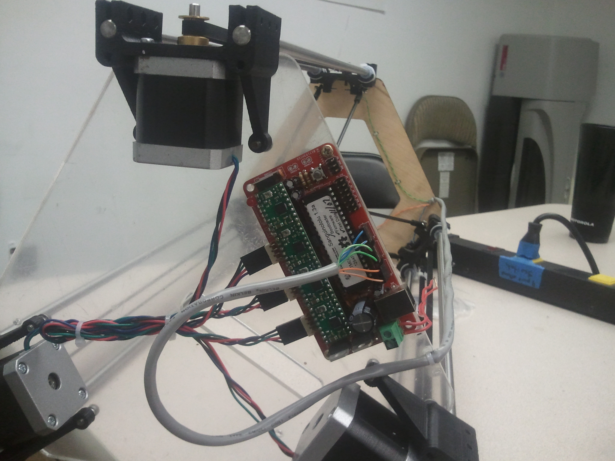

One of the things I like most about my Rostock is just how damn clean it all is. I haven’t ever seen another machine with wiring this hidden. Also - finally got endstops installed. Here’s a video of the rostock on the new delta branch quickhoming: http://www.youtube.com/watch?v=y4r6XQr039U

Honestly, the big drawback from this design is that it can get wobbly at larger heights. Firmware is Marlin, and has recently had all the latest marlin changes merged into the branch. The Kossel is the new build, and it’s built with T-slot, though I knew about it, I still opted for 8mm rod, as it’s what I know and was easy to source.
I haven’t had the luxury of printing with this yet. I still need to build some sort of extruder system for it. I’ve never done a bowden setup, so I’m sure I’ve still got a bunch to learn. I do have to say the build was the easiest I have ever done.
