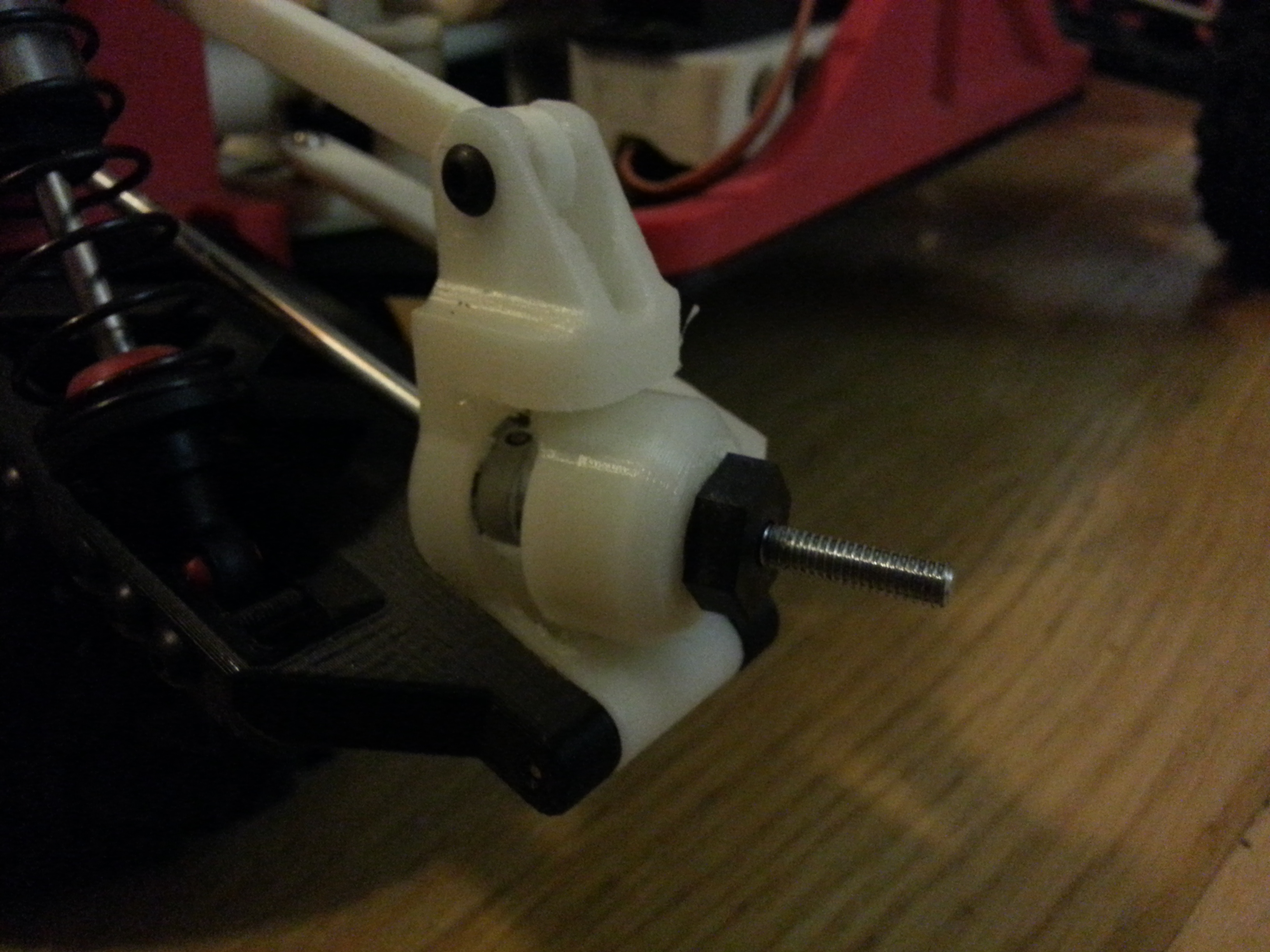

One of the weak spots just got a whole lot stronger printed in Nylon!

you wont regret the nylon :wink: its damn strong (but quite flexible)
