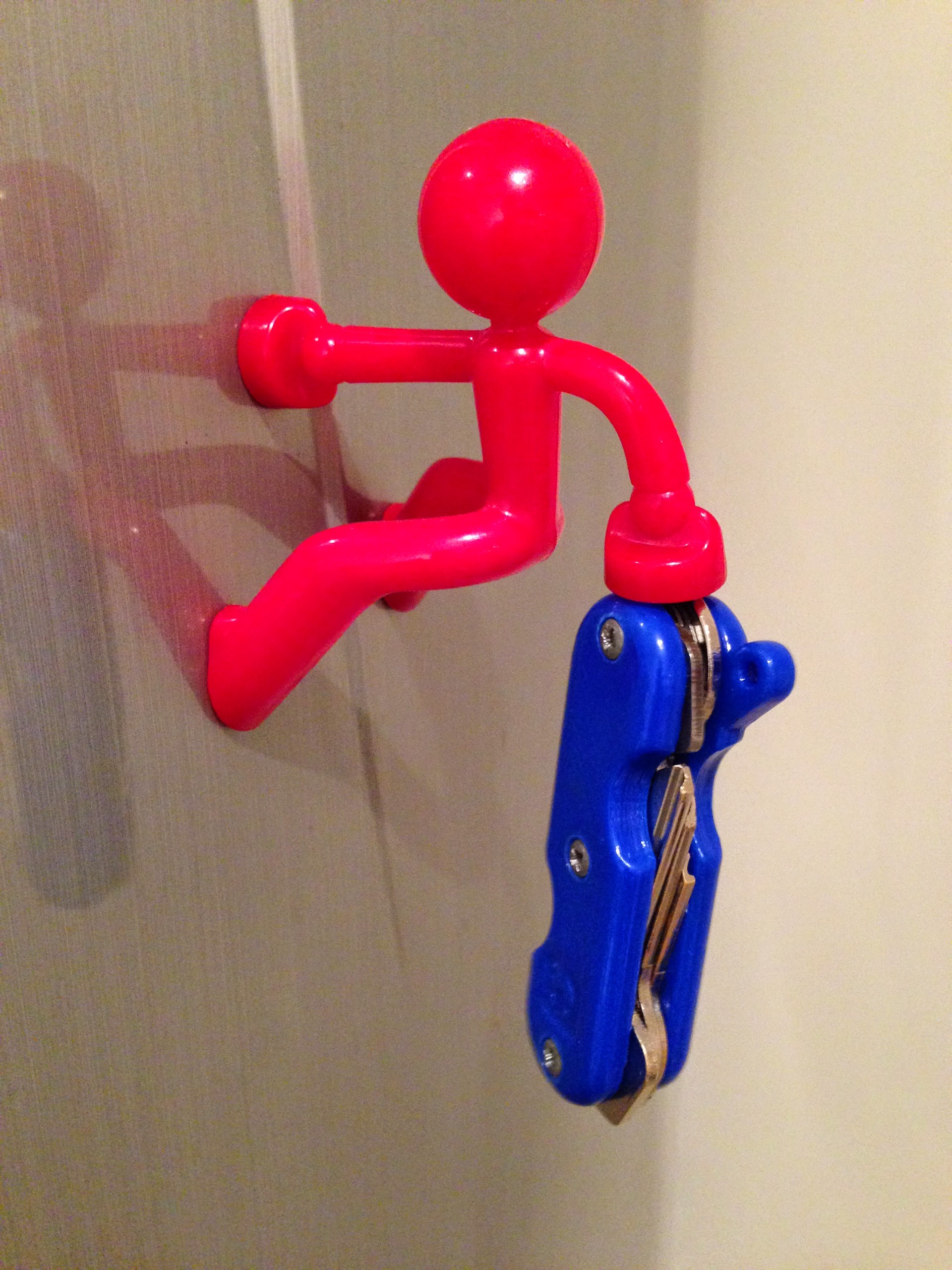

One of these things was 3D printed, most of you probably know which, but to the uninitiated…
ABS smoothed?
Yes, 20C for 2 hours.
What procedure did you use for smoothing it?
I put it in a saleable HDPE sandwich box next to a tissue soaked in acetone for 2 hours.

After cold smoothing does it still have the “soft” exterior vapor smoothing does?
@Mike_Kelly_Mike_Make Yes, takes about 2 days to return to a hard ABS surface.

What do I need to know for acetone-smoothin abs/pla?
PLA - no, not with acetone.
ABS - just put the thing in a waterproof sandwidch box with an acetone soaked tissue and watch it. No heat required. Remember it will continue to smooth for a while after being removed.
