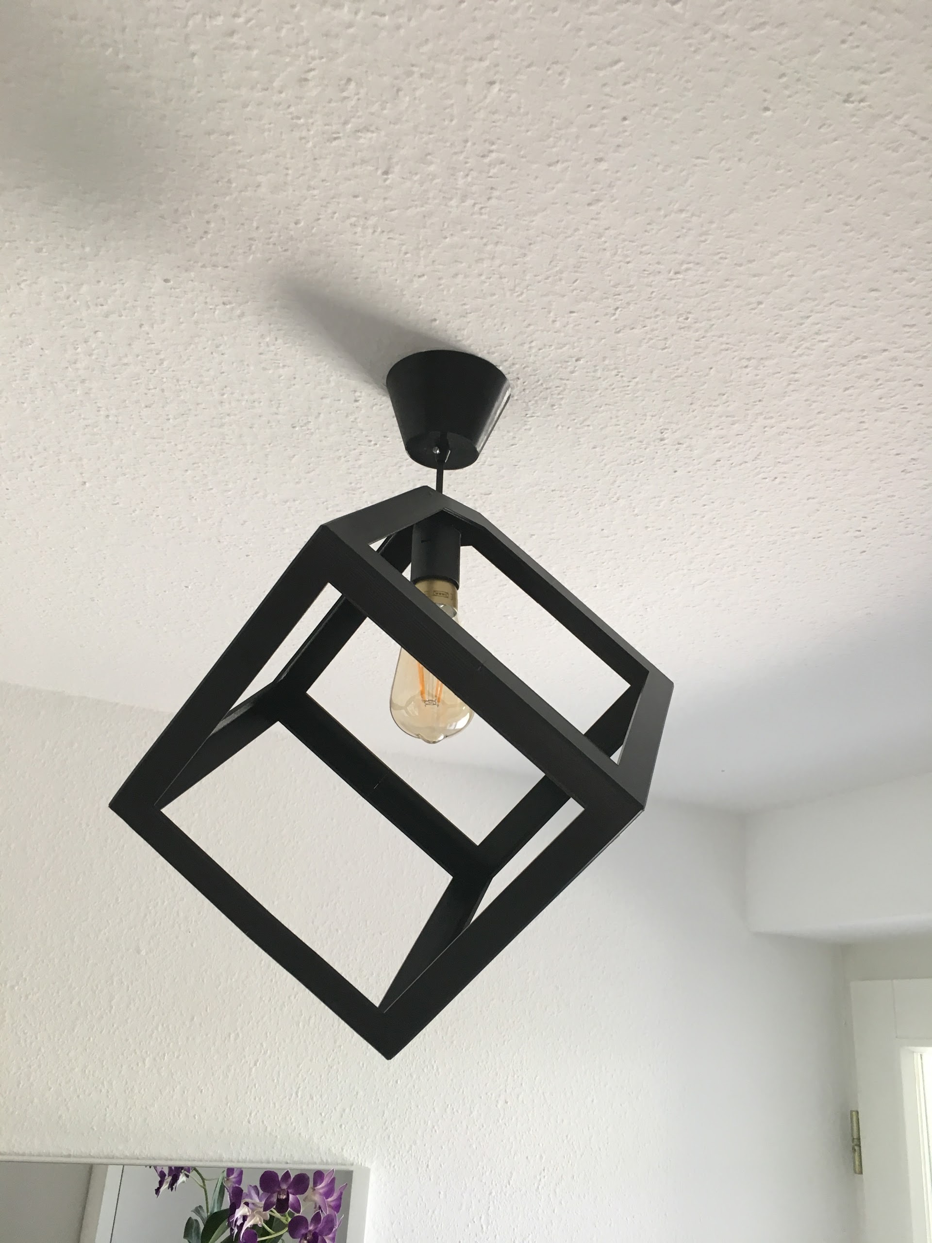

One practical use for the 3d printer: a completely printed light fixture.
One practical use for the 3d printer: a completely printed light fixture. The big cube is 25x25x25 cm big. It could have been smaller. Took around 22 hours to complete, made from two pieces glued together. PETG.
Good thing you used an LED bulb. I wouldn’t trust any 3D print near an incandescent.

we had the very same led filament light bulb, the filament is made of randomly mashed leds that are covered in orange uv pigment, there is a small ac to ac circuit that passes the alternating current over that ‘strips’ - so it changes the polarity of those strips rapidly, to light up leds that are in certain positions (mostly half of them) then it switched the polarity again and lights up the other half (more or less) unfortunately if any of those led are cheap quality or damaged during manufacturing process that will put higher current over the others, that will cause them to short their lives until more dies and then it will increase and kill even more until the ‘strip’ will fail to conduct at all, that is what happened with mine. now when I turn it on its like a disco with sound effects. I have another LED that is constructed of properly made ac to dc and array of 3 individually powered leds, this light bulb is still operational. I would recommend to buy something that have heatsink and less but more powerful LEDs , none of this ;comb; or ‘filament’ types that are made of randomly mashed leds that are basically frankenstein experiments ( connected straight to ac )
