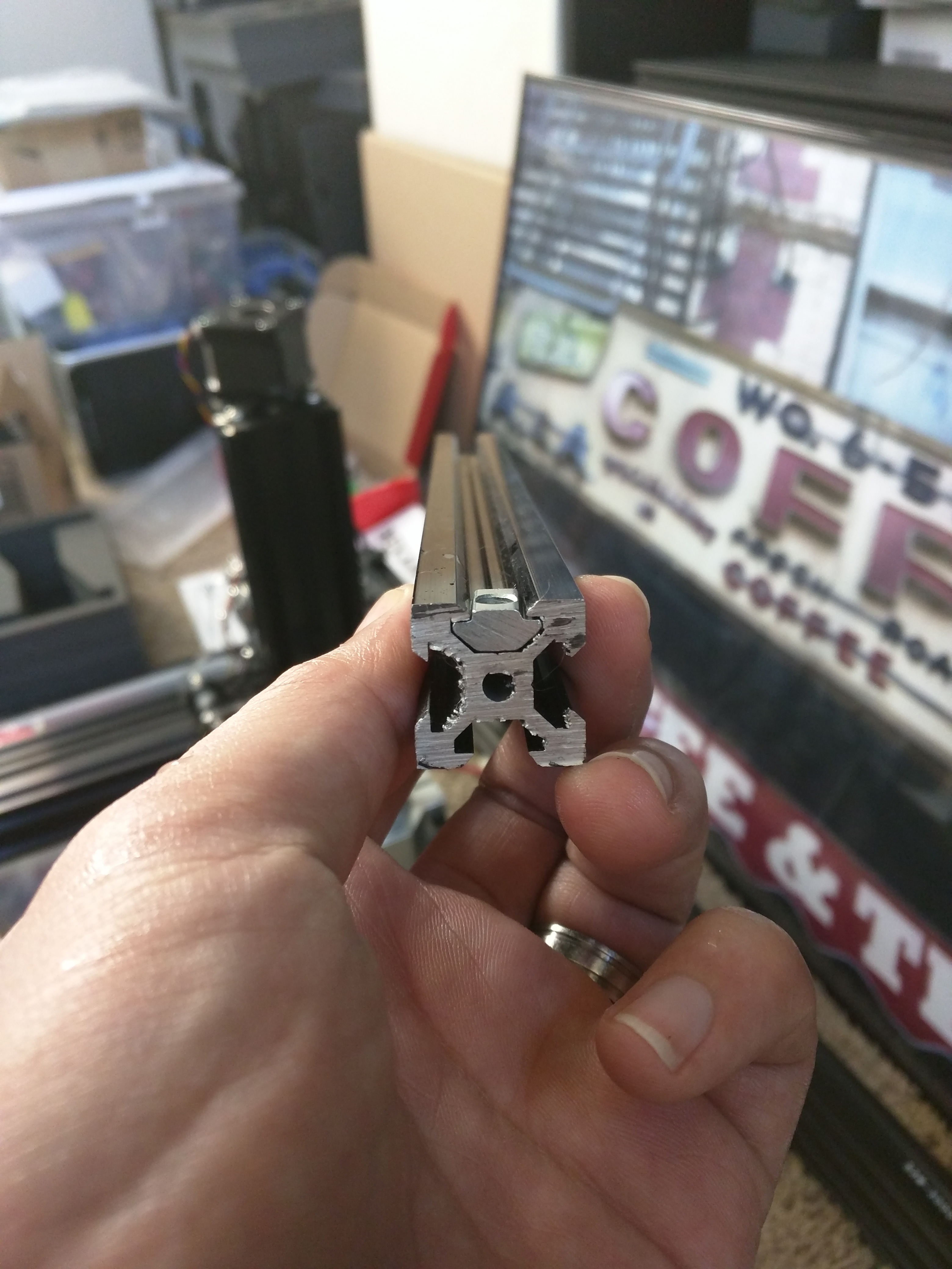

One step closer. Apparently adding extra nuts into the extrusion is easy from the

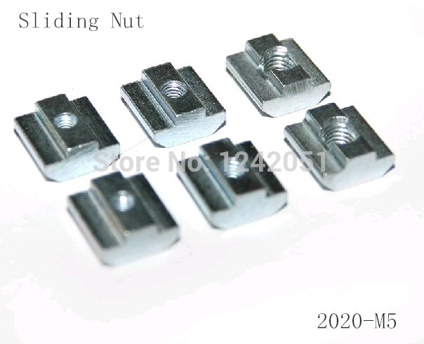

One step closer. Apparently adding extra nuts into the extrusion is easy from the bottom plate. I also found these nuts from China that fits both misumi and openbuilds extrusion. It’s also el cheapo. Perfect to complement the nuts I got from openbuilds.
Nice, you have a link?
Nice find! Must have link. :slight_smile:
$5.50 + $5 shipping for 50 pieces to US. If you buy multiple packs (why won’t you? If you are buying 1 pack, might as well buy it in your next openbuild order) it comes out cheaper than cheap.
@Dat_Chu Thanks!
@Dat_Chu Wow that fit. Thanks for sharing! I’m going to buy a few packs. Now to find post install t-nuts!
They have post install T nuts too but I haven’t tried.

I’ve been using them a while. Much, much better than the useless OB ones that twist and fall out. Apart from the delrin ‘tyres’ and the actual extrusion and the low-profile bolts, haven’t been very impressed with OB parts quality -and they’re charging premium prices for things like washers and switches… Way over what they are actually worth.
There are also these in case someone is looking for the drop-in tnuts http://www.aliexpress.com/item/100PCS-M5-T-nut-Hammer-Head-Fasten-Nut-Connector-Nickel-Plated-for-20-series-Slot-Groove/1638209928.html
They are awful - take it from me. They might drop in, but they are too narrow - they spin around and are more likely to fall out again. That’s the same as the OB store sells - at 75c for six!!! WTF? If you do want that style, buy the ‘4040’ M5 hammer-head nuts. They will drop in, but you can make them stay in place.
The best drop-in nuts are the ones with a ball and spring, but the opening on the V-trak is just a little too wide and they often spring back out again - you need to put them just-so.
That is the reason for the issues surrounding the t-nuts - the mouth of the track gap is wider than normal 2020 track.
I have about 10 different types of t-nut and have now narrowed it to only using two types with V-trak. The wide ones you originally posted and these: 30 series roll-in with leaf spring: http://www.aliexpress.com/item/30-Series-Self-Aligning-Roll-In-T-Nut-with-Spring-Leaf-M5-6-8-Thread/32255233047.html
