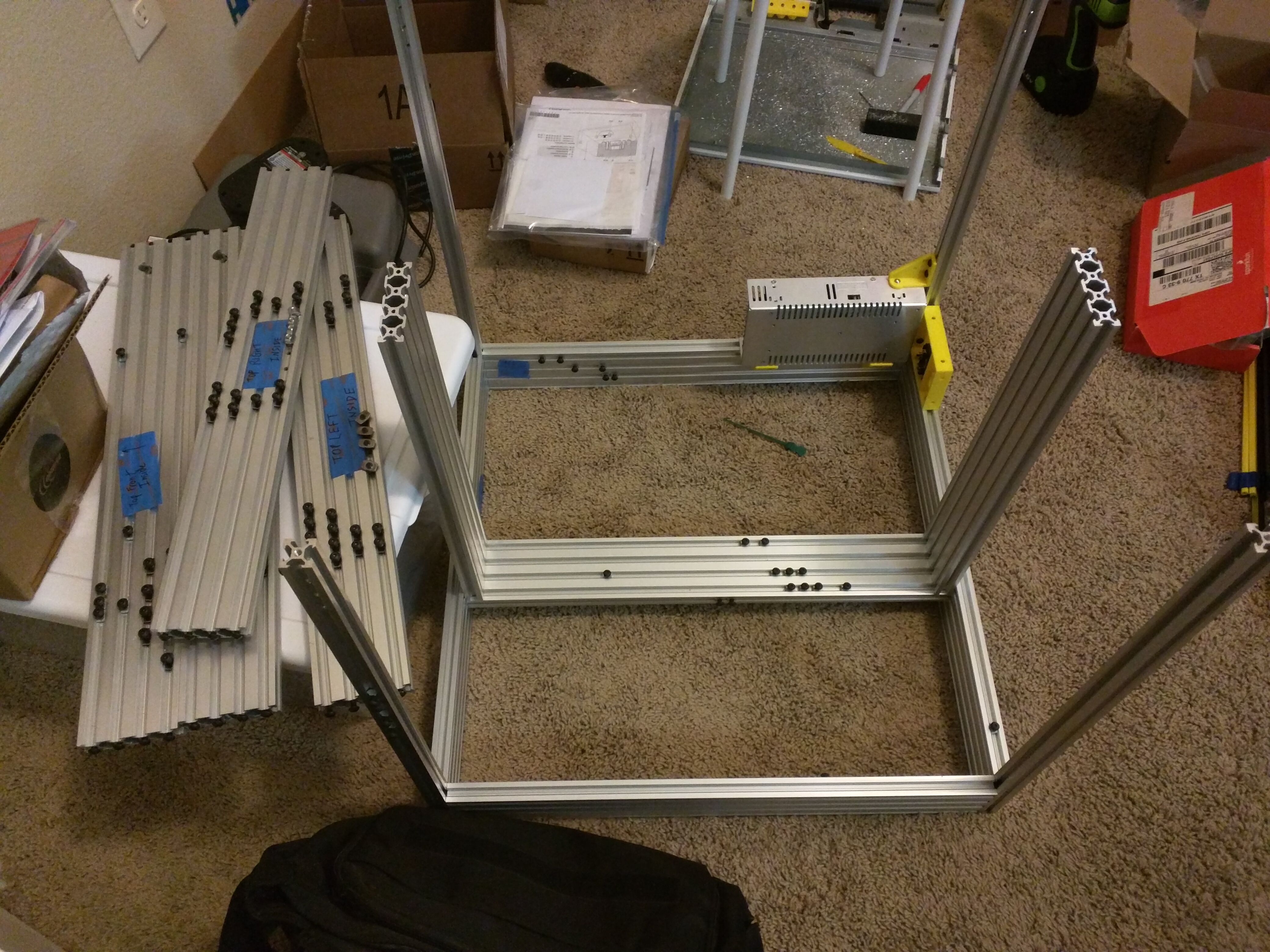

One step closer. I now need to source the aluminum angle L, the aluminum bed and the mdf pocket. I have been putting off on these since I have had the time to call around town for a metal shop that has them.
If anyone knows a better place to get these in Houston than ordering online, I would love a suggestion.
Your local hardware store might have the aluminum angles. Looks like your making good progress. I was able to substitute a 1/8"x 1"x 3" angle and with a volcano head it worked out for me. The added 1" on the vertical will make it more stable as the roller bearings are further apart.
I might change my Z configuration and use 3 ballscrews with linear shafts and not use the V-grove roller bearings
