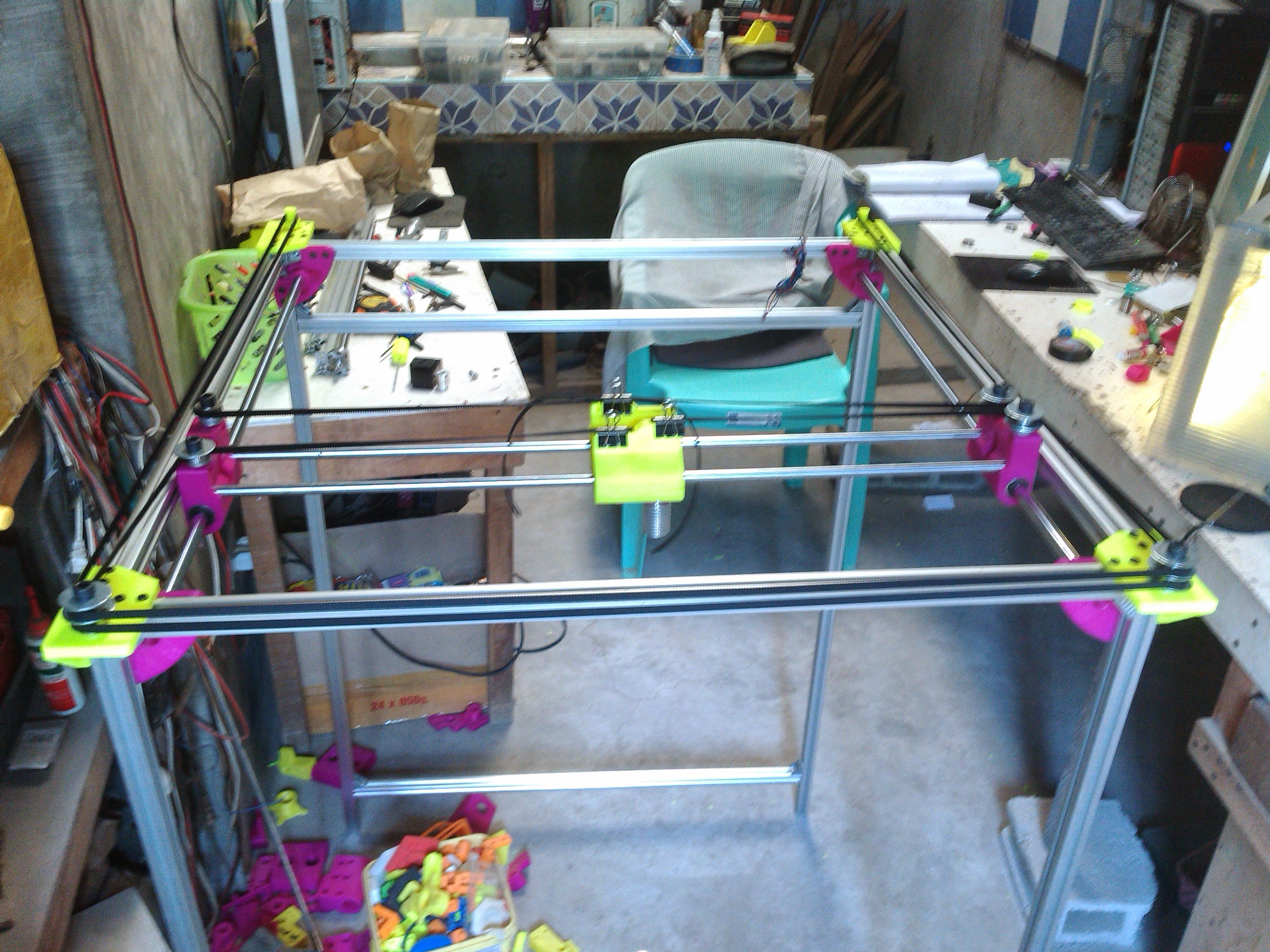

Man, that thing’s a MONSTER! Is the frame solid?
@lynnroth It is mainly the little 4nn screws and the TEE nuts. These are turn left and they will come out and turn right and they will Tighten down. Thats the plan of how they work but it is hard to get them to lock. Have to unscrew the screw to the almost fall off point before the may or may not catch to tighten. If you go to far they may come unscrewed and slide out.
@Carlton_Dodd Ya that’s what i thought. Its just the screws are hard to get to tighten. I don’t know if all extrusion is this way, or the new stuff we been seeing on Kickstarter but this kind is not easy to get tightened up. Need 4 hands. At least for me.
@Mike_Miller Ya is big. 24x24x24 To big really but its not for me. Not solid yet. I hope later it will be
Looks like it needs gussets or diagonal braces…
Yes but i am not to that point yet.
@Eclsnowman You see how the belts are not aligned straight, one on each side. Is that going to be a problem?

@Wayne_Friedt I think there may be tension issues. The optimal length and tension would change (I Think) depending on the position of the gantry back and forth in x and Y since things are not aligned. Also the force of the belt being so high on the y axis carriages may lead to issues because the fulcrum they have down to the x rods. The rods don’t engage much into the carriage (mine either) so when you get good/high tension on the belts the carriage will want to tip down.
@Wayne_Friedt Your belts must be absolutely parallel on X and Y - I would expect racking due to cosine error once they’re under significant tension. And a machine this size should really be moved up to something like HFS5-4040 for the pillars and main members. That much mass, that far off the ground is going to be an issue at even modest speeds. Seriously - reinforce the frame to semi-ludicrous amount, especially if you’re going with printed gusssets. Strongly consider aluminum gussets. And the belt bath can probably be fixed by moving to a larger toothed gear on the Y-end and then pushing it’s position away from the center of the Y-axis. @Eclsnowman is absolutely correct in pointing towards an XY axis that occupies the same plane as the belts. You should check this thread: http://forums.reprap.org/read.php?4,297740
I’ve been working on a similar coreXY machine in CAD and the refinements I’ve had to make for alignment issues to maximize the XY print envelope have been pretty ugly.
@Wayne_Friedt I see the cause now. You have only have 1 corner idler. So at least one of the belts (coming off the stepper to the idler, or off the corner idler to the cart idler) will then have to be misaligned.

@Eclsnowman I think i am going to fix the idler issue, add in 2 more to square up the belts and see how things look after that. I am not sure what to do about the belts being so much higher above the rods. I may just go with that for now and see how that turns out as-well. Thanks much.
