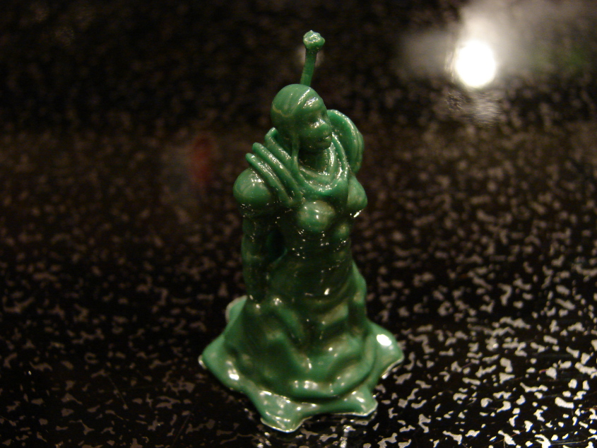

Oops… Left her in the acetone vapor bath a little too long. I’ll have to try again.
What type of 3d printer are you using ?
She’s melting, meeeeeeeelting… oh, what a world, what a world.
@Kacey_Young1 Printrbot PLUS. Sorry… forgot the link to the original post with all the information. https://plus.google.com/u/0/109651299134991445959/posts/DRGKkHedxst

@Kacey_Young1 I don’t know. Here’s the link to the original model on Thingiverse. http://www.thingiverse.com/thing:33804
I like it… I would have use some jewelers tools to add more detail.

blob girl!
Can you explains your vapor bath process?

A jar or container that doesn’t react to acetone. Put some acetone in the bottom, heat a bit until the acetone vaporizes and you see condensation on the sides of the container higher than your object height. Insert object via a creative method (hanger, glass plate on a hanger, etc). Choose path A) or Path B)… Path A) Leave it in for a long while until it looks like what you want, extract carefully and let it ‘dry’. Path B) Leave it in for a bit until it dissolves a bit, then remove, let the acetone evaporate, repeat over and over until you get the results you want.
I going to put together a video today on how I’m doing it. Stay tuned!
