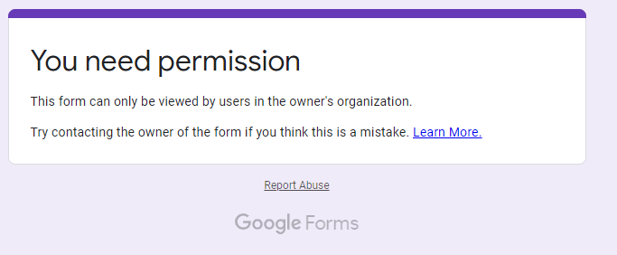

Looks like your form is not public??
Ah thank you for mentioning. Just fixed it.

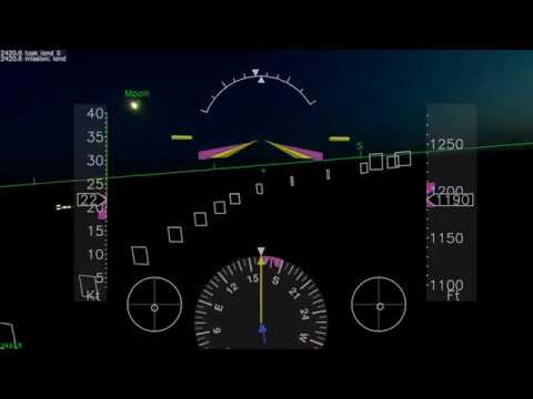

Edit: I’m sure I’ve shared this video before, but here’s our system in action (landing) with some augmented reality added in post process (based on our EKF, so it’s sort of a visualization of what the autopilot was thinking drawn on top of the actual camera video.)
Edit #2: details that I think are worth noticing is where I use the EKF solution to estimate where the moon should be in the camera and then draw where it should be (if the EKF was perfect) and then seeing the moon pretty close to that most of the time. That and the position of the horizon line vs the actual horizon gives an indication of how well (or poorly) the EKF is tracking truth.
