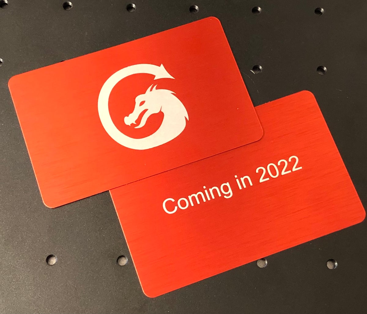

@Bryce what do you think, are they using your work there:
Yes, but it’s all above the board and legitimate. I talked with LightBurn and we shared reverse engineering data some time ago. This was after Balor substantially worked, but the exchange was mutually helpful as it helped me to sort out some details about how buffering is handled.
I am glad people will soon have not one but two EzCAD alternatives, maybe even three, at least one of them open source / free software.
