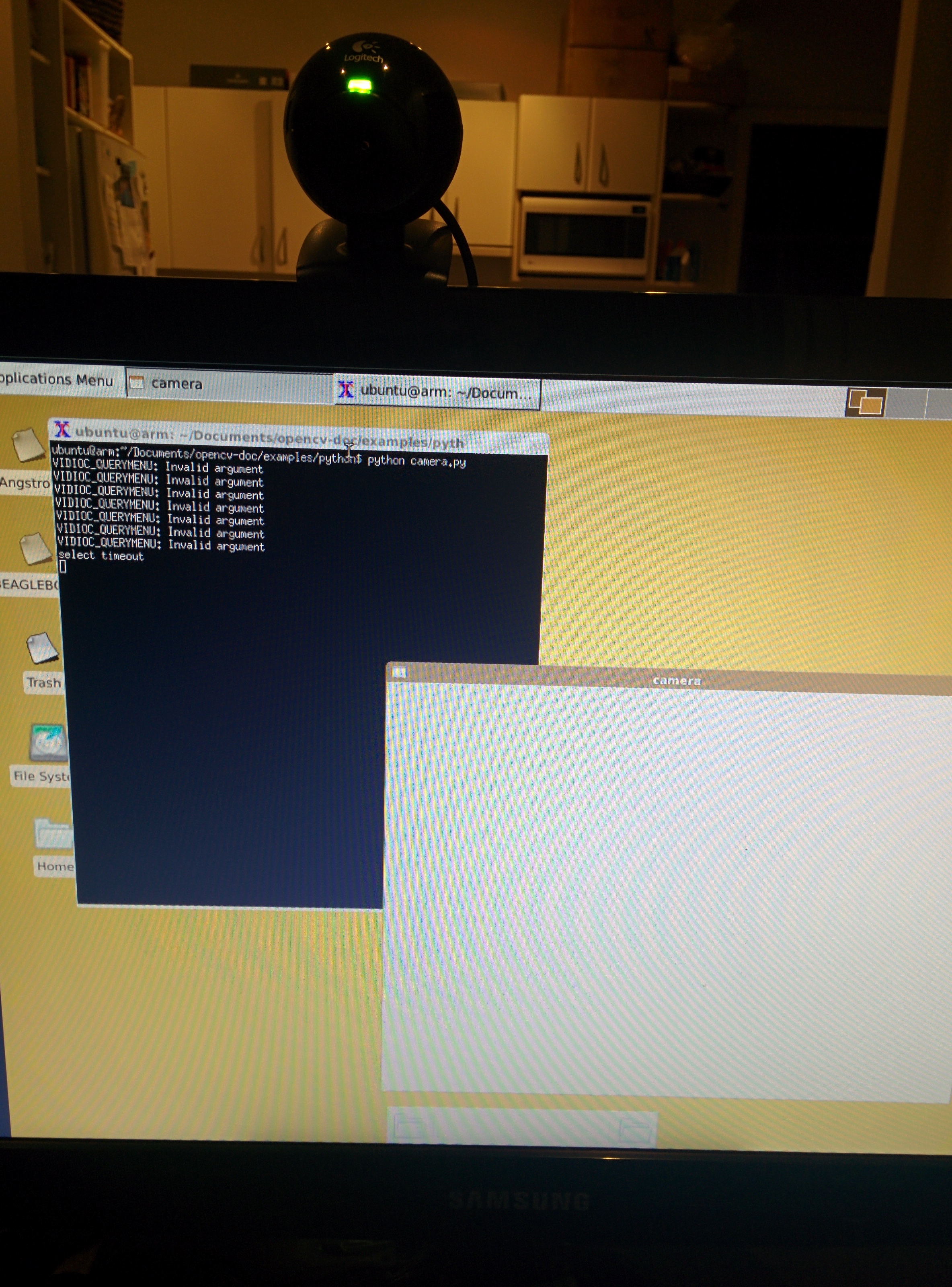

Opencv camera.py doesn’t show an image. Using latest Ubuntu image, updated libraries, compatible USB hub + webcam. Anyone had same problem?

@Derek_Molloy thanks so much! Have now got a partial image. Draws ~20% of image from top down but then stops and rest of the window remains green. Window freezes and won’t close when I hit and I’m forced to kill it. Any thoughts on what to try next? Thanks again for your help.
