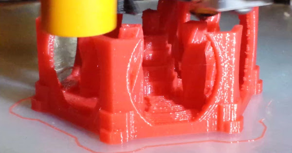

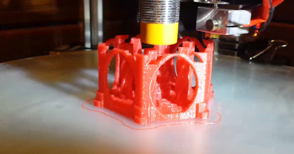

Opening the hostilities with the delta contest. I’ve printed something shriny:

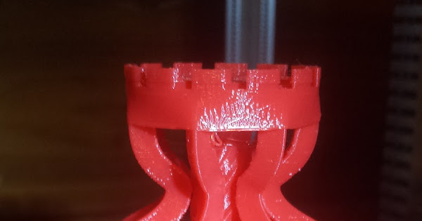

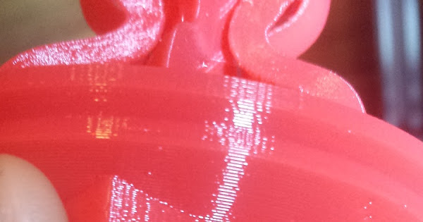

If I had known I would have scaled it too. Shoot. Well here is my 80mm/s PETG. I need to dial in retract a bit, but not bad for PETG with so many retracts:
I need to dial in retracts before I go much faster… At least with PETG.

@Michael_Memeteau yeah, PETG is just what I had loaded. I got lazy. ABS is my preferred material for high speeds. For acceleration I have it at 9000mm/s^2. Travel moves and Z lift at 300mm/s. Jerk is not the same in smoothieware it is called junction deviation, but it is at the defaults still. Speed was 80mm/s, 2 perimeter, 15% infill, 80% on outer perimeters.
4.5mm retract at 70mm/s.
