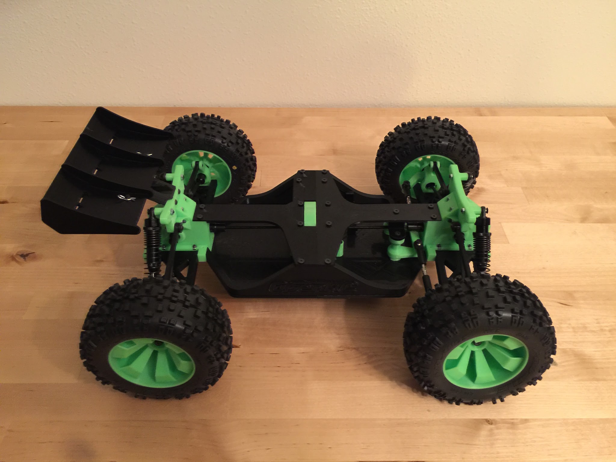

OpenRC Truggy with Bitfrost all metal driveline…just need electronics…
Looks great. Which tires did you use?
Wow, @Brendan_Madden that looks sooo good! Congratulations on a job well done! The rear wing looks great btw!
proline badlands 2.8
@Daniel_Noree Thanks, I modified the steering slightly for better steering during the suspension travel. I am planning on building your rally car next!
very very well done. So did you use different axles than the one from conrad? Also, did you need to modify the wishbones to fit?
@Brendan_Madden Looks awesome, I love the two toned. Did you ever get it running? Did you use the stock steering config or something modified? I’m building one with an all metal drive train and used the updated differential case which is a little larger and hits the stock steering setup. tnx
