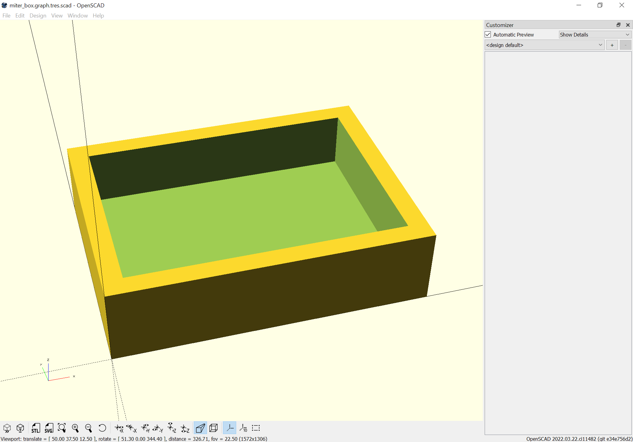

Experimenting w/ this a bit — modeled a simple mitered box:
Only inputs were:
  • Height
  • Width
  • Depth
  • Stock_Thickness
and whether or no one is getting a 3D Preview, and the flat view is:

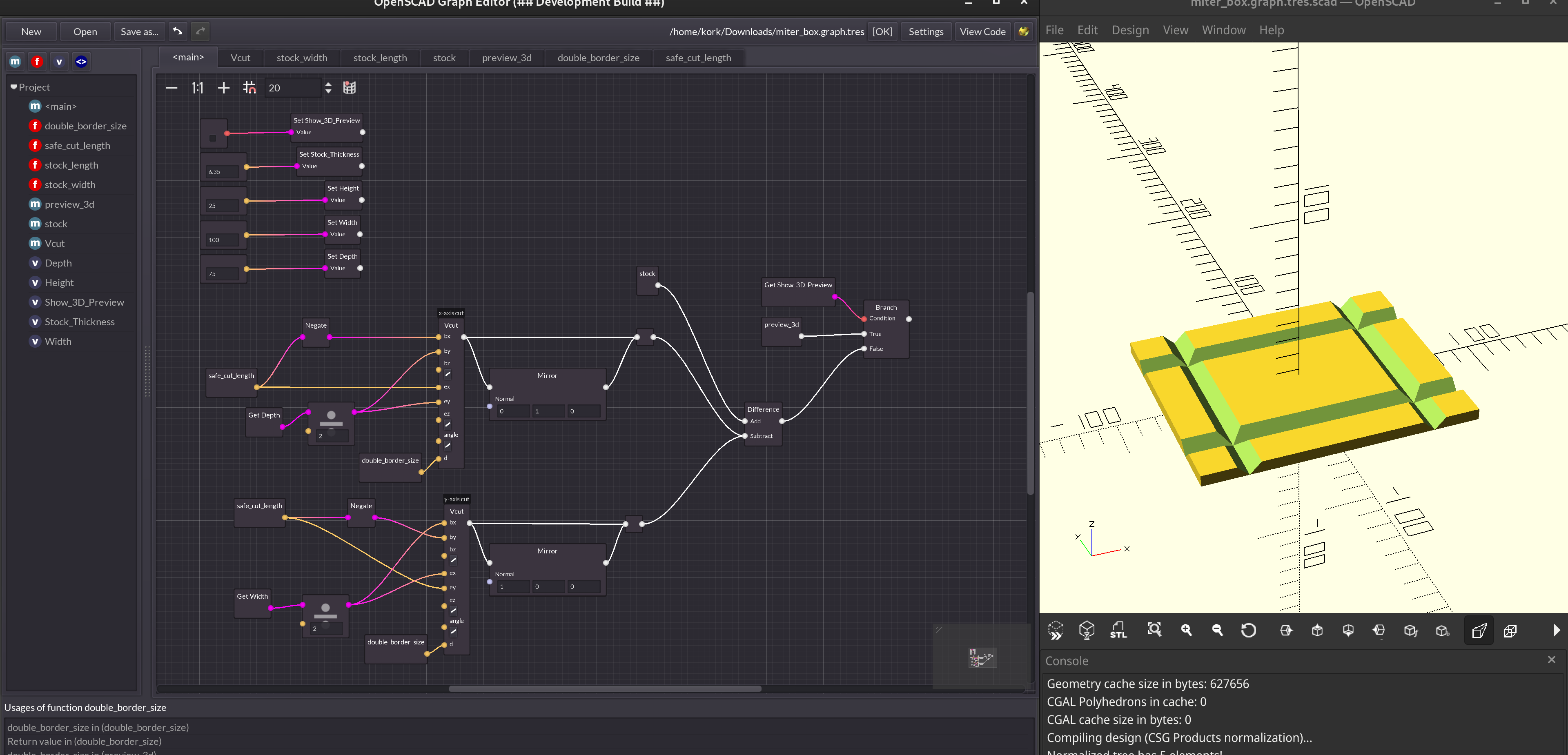

The code however, looks like this:
and it’s missing many of the niceties which I was pretty easily adding using BlockSCAD.
Probably a lot of the lines could be cleaned up by instantiating more “Get_foo” blocks (where foo is the desired variable name)
A few things I have noticed that could be done right now to make the graph more readable:

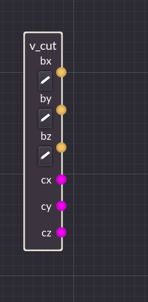

  • If you give the module parameters a proper type (e.g. number instead of any) you can type numerical values directly into the node. E.g. consider this vcut module:
    and now we use this module inside our main graph:
    As you can see the parameters that have type number will give you an edit field where you can type the number directly where the any fields do not.
  • Modules can have default values for their parameters if the parameters have a proper type. When you click the pen icon next to a module parameter (inside of the module graph) you will get a text field which allows you to specify the default:
    when you use the module, you can override the default value by clicking the pen icon or you can just connect another node which will also override the default value

I have added a few helper functions for calculations needed in multiple positions and moved the preview into a separate module. I have also moved the model into the center, so we can use symmetry to do some of the work for us. This greatly simplifies the graph:
