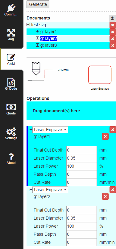

Operation Diagram. +Peter van der Walt created the SVG.
oh my god it’s beautiful!
This is really turning out nice guys well done!
One thing to make it better is travel direction when choosing between climb and conventional cutting with an arrow showing the travel at the start and end of the travel
It may be more useful to somehow guide users which cutting direction to use. Since I doubt LW will be used with rigid zero-backlash machines with tight spindle speed control, it’s best to recommend conventional cutting for non-finish passes.
how do i use this? my outlay doesnt look anything like this. I just finished building my shapeoko 2 and needed opensource software and used laserweb3 and then to my surprise i can use same software by enabling cncweb mode for milling…decided when i make some money from my cnc i’ll donate the proceeds from the first job to the creator since the software is so useful.
