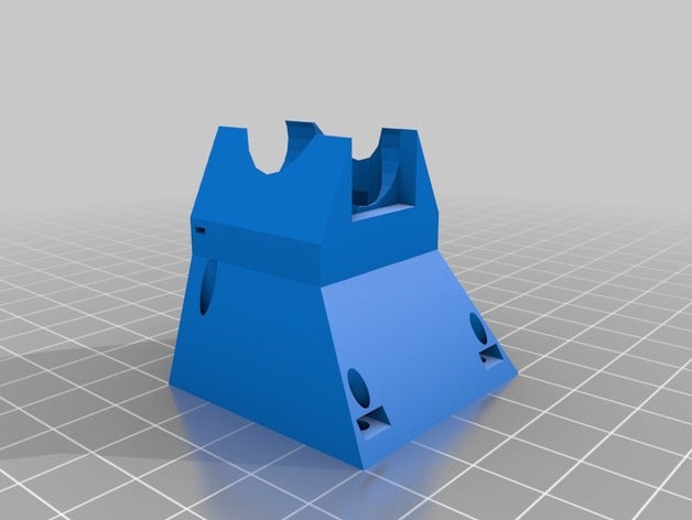

i also ordered another fan so ill print some mounts, maybe an e3d style one for the fins
I use a 25mm fan for the fins
ok, i ordered a 40mm but i found this
ill rob a 25mm fan off my rc car, i have 2 on the motor and i only need one
